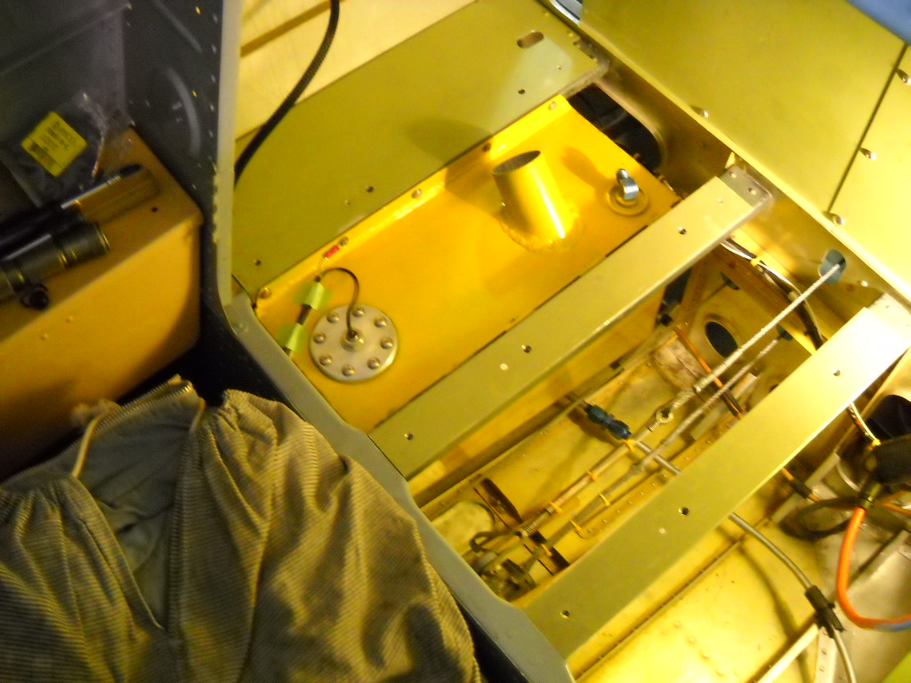

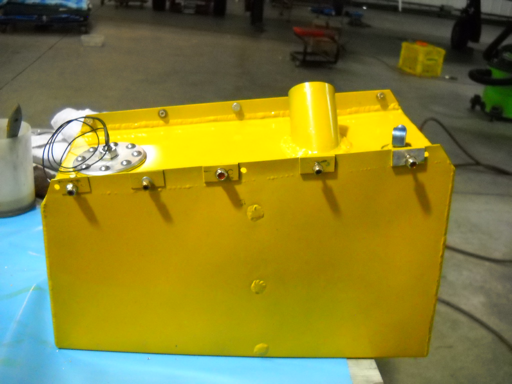

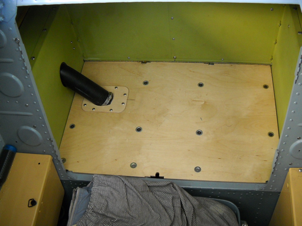

Hi Craig;
Here is a very simple one using the original elec./avionics space. It is placarded to a max. of 50 lbs. the approx. weight of the removed equipment which transferred that load directly to the floor support structure.
It is fully enclosed and does not compromise the weight and balance situation as a further aft system would. The floor is 3/8” aircraft grade birch plywood.
The hose is a later addition to fill the smoke oil tank below the floor.
Walt
