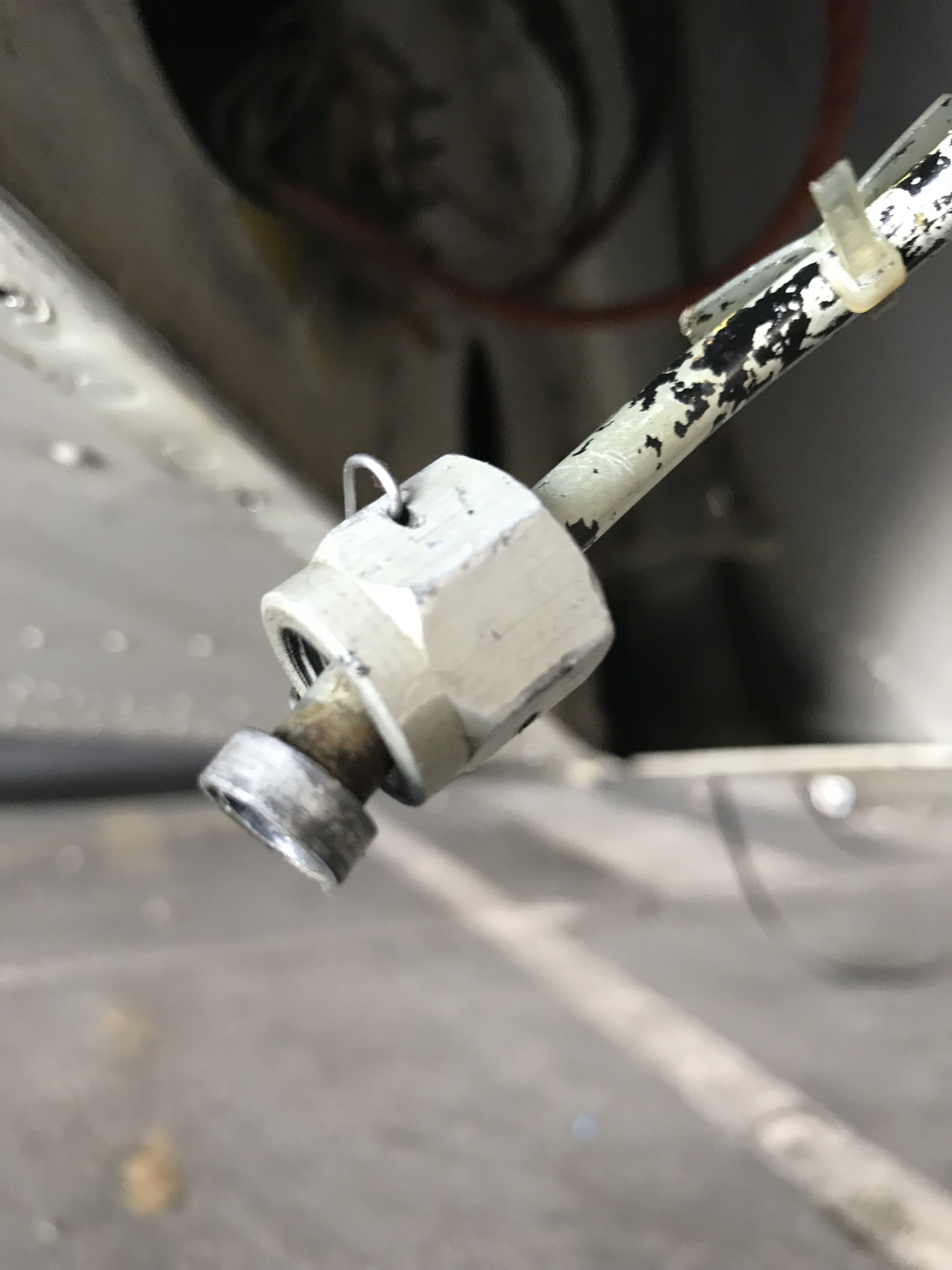

Hi
anybody has the AN references for nipples and nuts we can use to retrofit the air system with 1/4 tube?
thank you so much.

yakflyer(at)aol.com
PostPosted: Fri Aug 16, 2019 11:56 am    Post subject: Russian Air Fitting Reply with quote
Call Hose Power.
520-623-0531
They have the correct fitting.

PostPosted: Fri Aug 16, 2019 12:38 pm    Post subject: Russian Air Fitting Reply with quote
You have to reuse the Russian/Chinese B-Nuts and use an AN4 sleeves for the flare on the 1/4" tubing.
https://www.speedwaymotors.com/Aluminum-Tube-Nut-Sleeve-4-AN-1-4-,34350.html
Doug usually has B-nuts for sale if you mess one up.
