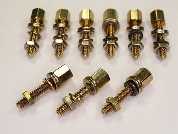

Yeah. Looks like these
[img]cid:7.1.0.9.0.20190417182319.054d98d8(at)aeroelectric.com.0[/img]
Got a boat load. Send me an address and
quantity needed. I'll drop them in the mail.

argoldman(at)aol.com
PostPosted: Wed Apr 17, 2019 6:15 pm    Post subject: Water resistant D-Sub Reply with quote
Beg to differ, Bob.
The devices to which I referred were totally of the female gender persuasion. The ones that you showed are male on one side and female on the other.
Not so my suggestion. Both sides are female with opposite threads and are sized to hold two sub ds together. See b& c catalog with the stock number that I indicated (unless I was dyslexic when I copied the number. )
Rich

echristley(at)att.net
PostPosted: Wed Apr 17, 2019 6:29 pm    Post subject: Water resistant D-Sub Reply with quote
That's what I'm using on my firewall to engine sensor bundle connector. Keep in mind that these won't fit on all shells. I actually have a bag full of shells now. Smile
