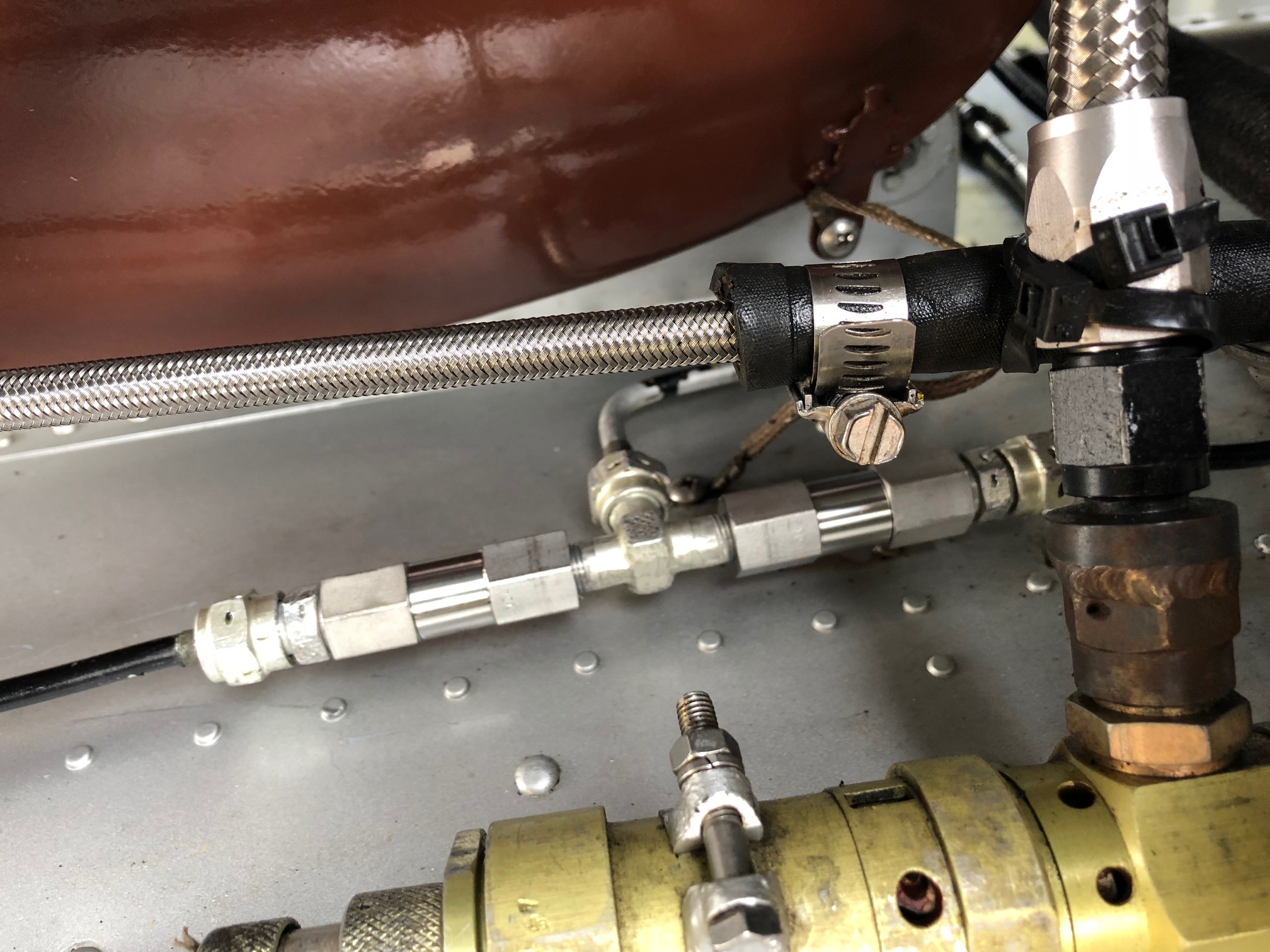

On occasion, after rebuilding the CJ check valves, they will continue to leak for a week or two. The hard rubber disk over the metal cap on top of the spring may take a while to properly seat. Soaking the hard rubber cap in glycerine sometimes helps. A few will continue to leak no matter what and need to be replaced. A simple test of individual check values before going through the trouble of installing them is to connect an air pressure gauge via a B-nut on the outflow side and then pressurize the inflow side to 50 ATM (735 PSI). After turning off and removing the air source, the pressure on the outflow side should hold. A common point of failure and annoyance is on the right side of the oil tank where a pair of check valves separate air flow into the main and the emergency systems.
It’s also not a bad idea to replace check values that have been in place for a long time. The amount of internal corrosion can be astonishing. Attached is a picture of what typical check valve corrosion looks like.
Hope this helps,

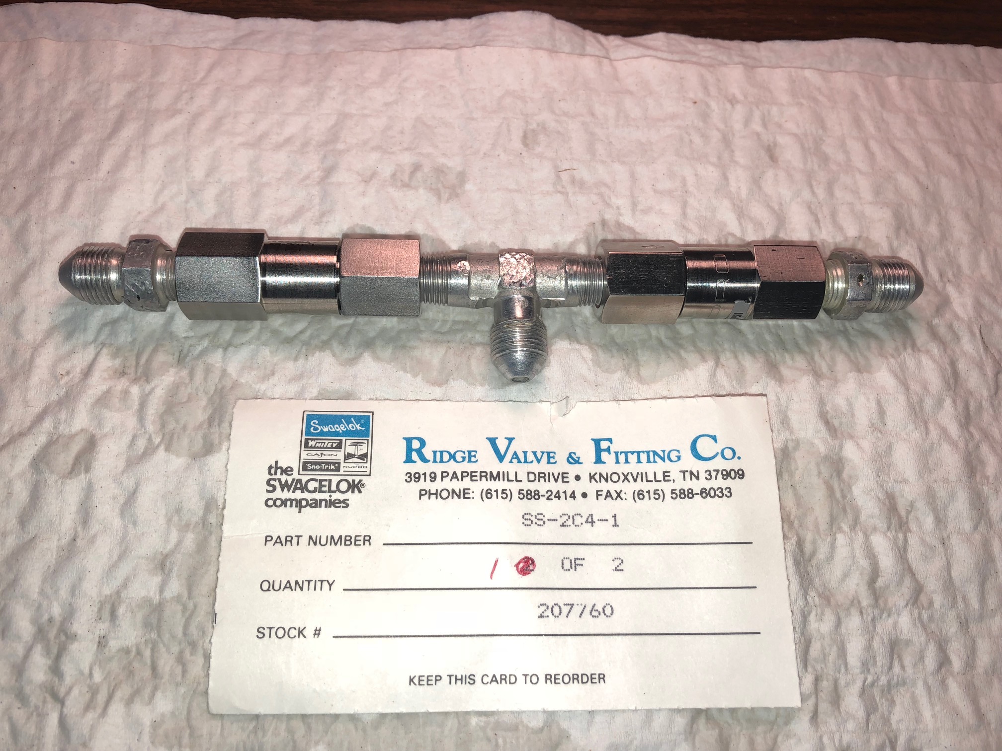

You could also replace all check valves with Swagelok check valves which are an easy drop in. Problems solved and no more fiddling with rubber discs/crush seals and bodies which loosen. All six for about $280. To me worth the price to improve health of pneumatic system. Old nipples with flare are transferred and work with a 1/8” NPT Swagelok. Part number is “SS-2C4-xx (last number is “cracking pressure” which is not critical, may be 1/3, 1, 10 and 25 , I believe). See pics.

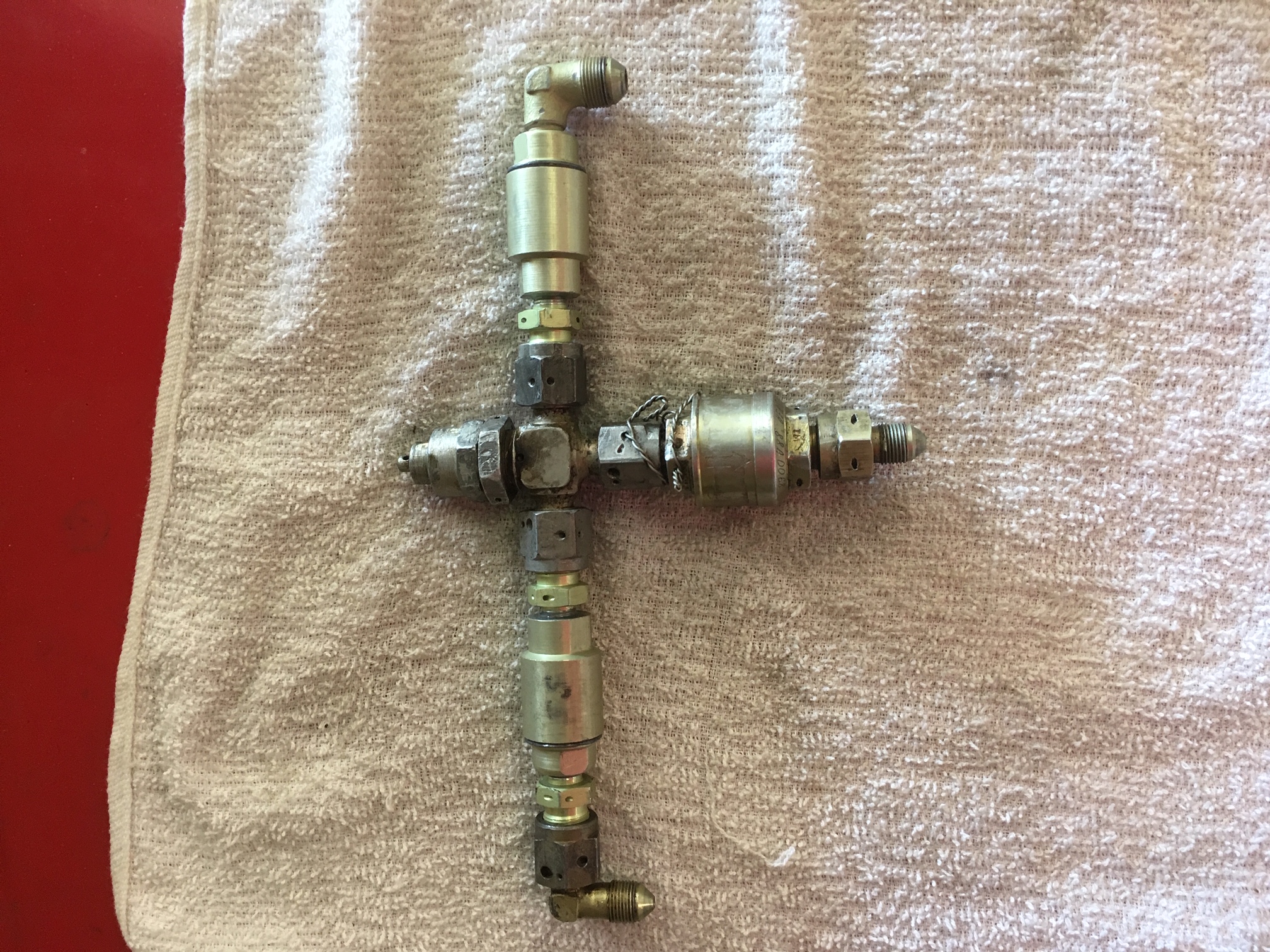

Sounds like the system check valves on the firewall are leaking. If one is leaking they all will eventually leak. May as well replace all three.
This is the T rebuild using CJ new SS check valves from Doug Sapp. You will have to wrap the valves with anti chaff tape to get the correct diameter when you anchor the adell clamps on the firewall. There is a L beam firewall stiffener that the B nut will chaff on if you do not put a chaff tape spacer on the check valve barrels.
Doug has a kit that has all the needed check valves to replace your existing leakers.

Some have not had good luck with the Swagelok check valves. One member of our group had four of these fail on a trip to Oskkosh several years ago. The more robust Chinese replacements are still working. Where Swagelok does a great job is for replacing the original Chinese main and emergency air on-off valves as described by Jason Berman. Mine have been fine for years. The smaller size requires two simple adaptors so the connecting air lines don’t have to be re-done. Attached is a picture of my emergency on-off valve with adaptors that duplicate the original line positions. For those who have not yet done this replacement, the current black handle valve for the main air is part number SS-42GF2-A-WN2 and the red handle part number is SS-42GF2-A-RD-WN2. Replace and forget. Really nice. One less thing to cause problems.
