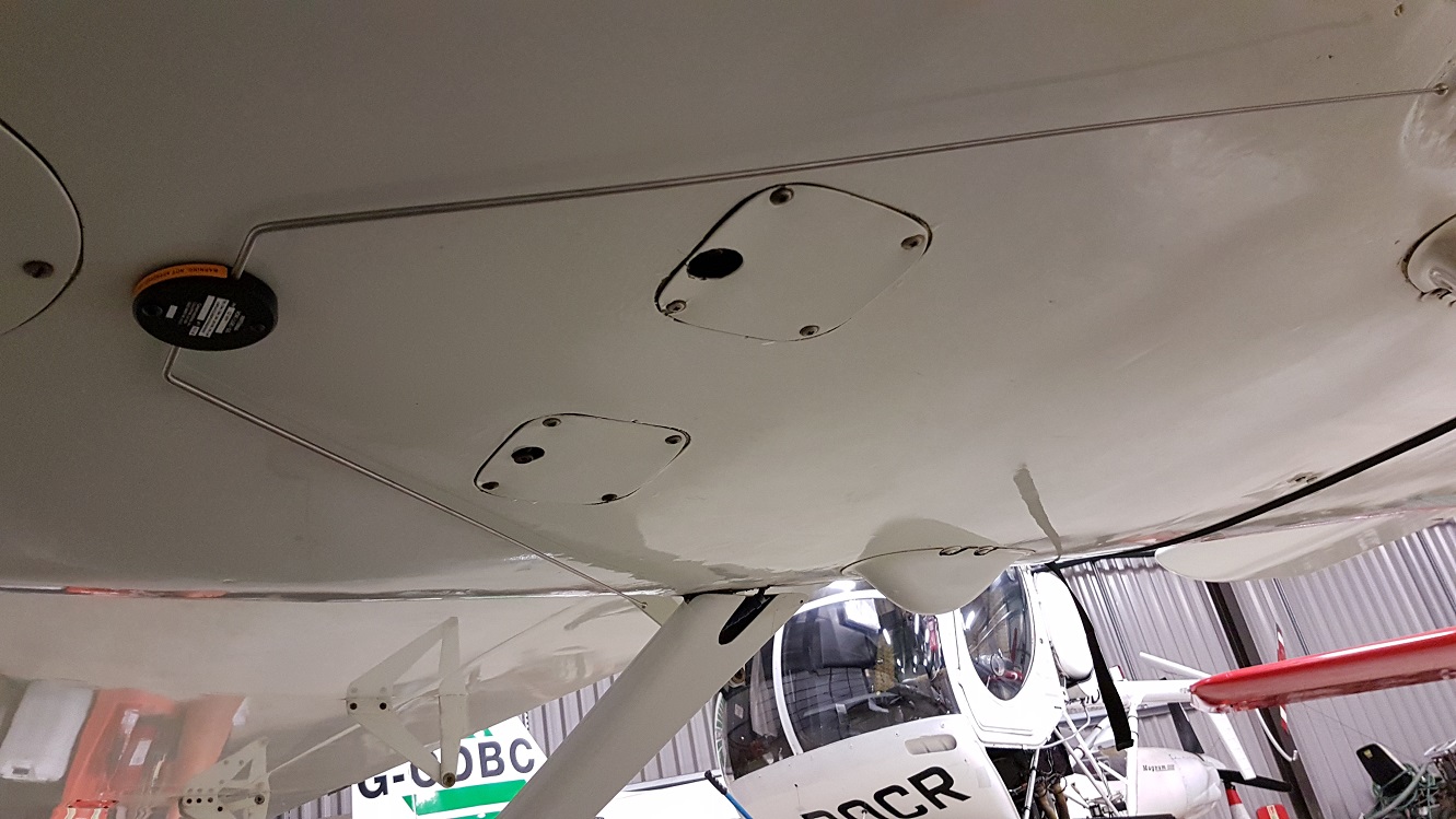

I've just fitted a VOR/GS antenna on the belly of my Europa Tri-Gear just aft of the hatch for the central tunnel on the underside (see attached pic). It works a treat and it's all signed-off by the LAA inspector! It's a CI 157P antenna. You can either have the V of the antenna pointing forwards or backwards.
Carl
G-URMS
