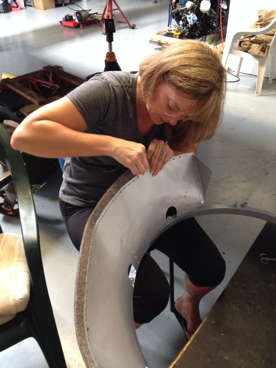

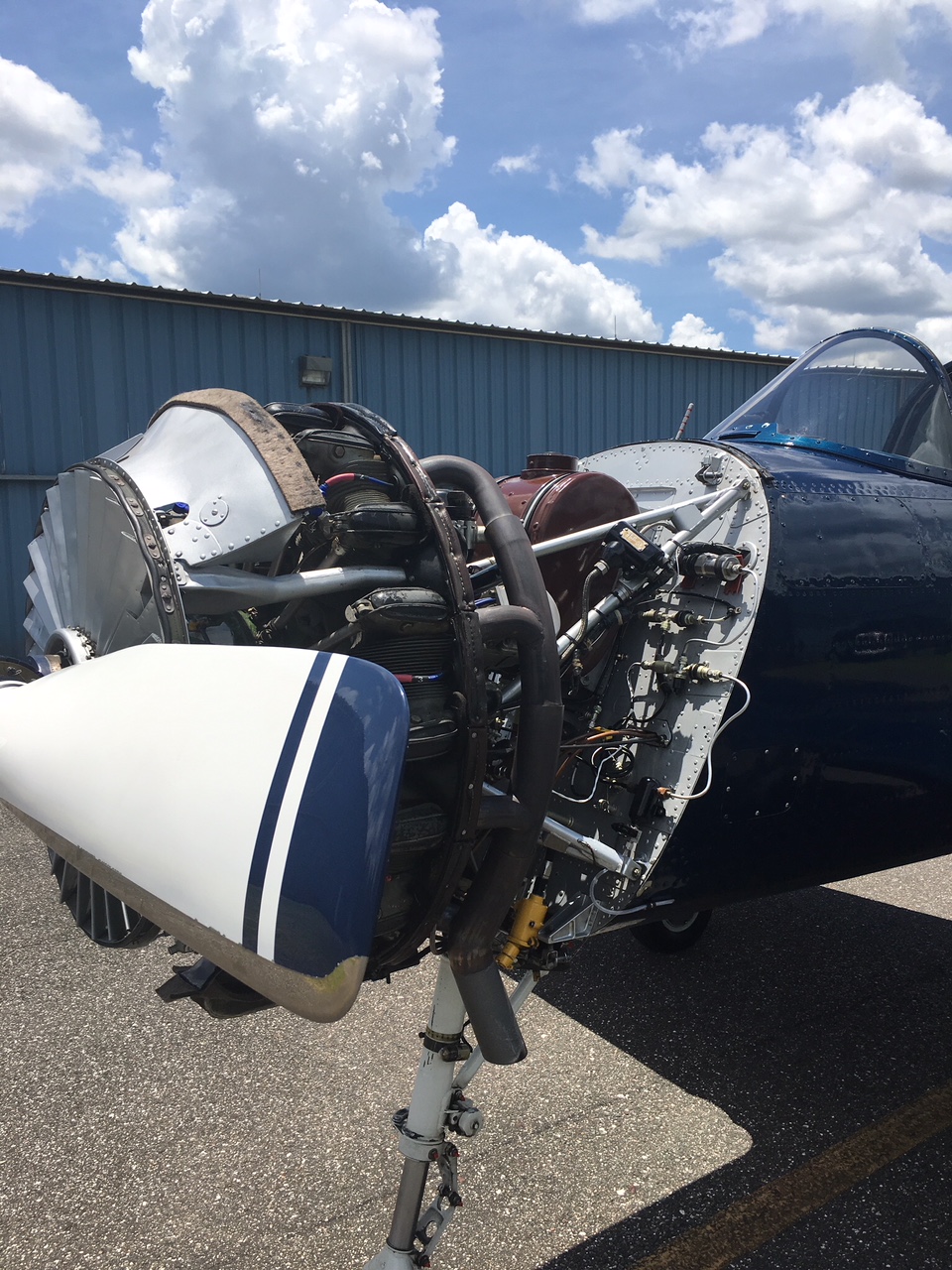

I used some felt strip (2x120”, 3/16” thick) from Grainger (Item #2FJB9) and Polycord waxed thread (.030) from www.mainethread.com. and my better half sewed it on. Works fine but one corner needs re-sewing, but afraid to tell wife her work was sub par, ha, ha!😅 so it’s flapping around a little on one end, but only on a cowl off engine run - Hoot
