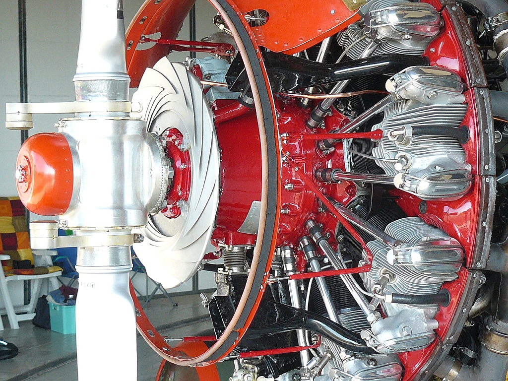

I have replaced the Yak shutters on the 18 T with a Sukhoi iris for easy access and better view of the engine. Expect to be faced with a LOT of friction in the actuating linkages and lever. I do not know how the system works on a Sukhoi but anyway we fitted a longer lever and bigger knob in the cockpit for that reason so be prepared for some troubles.

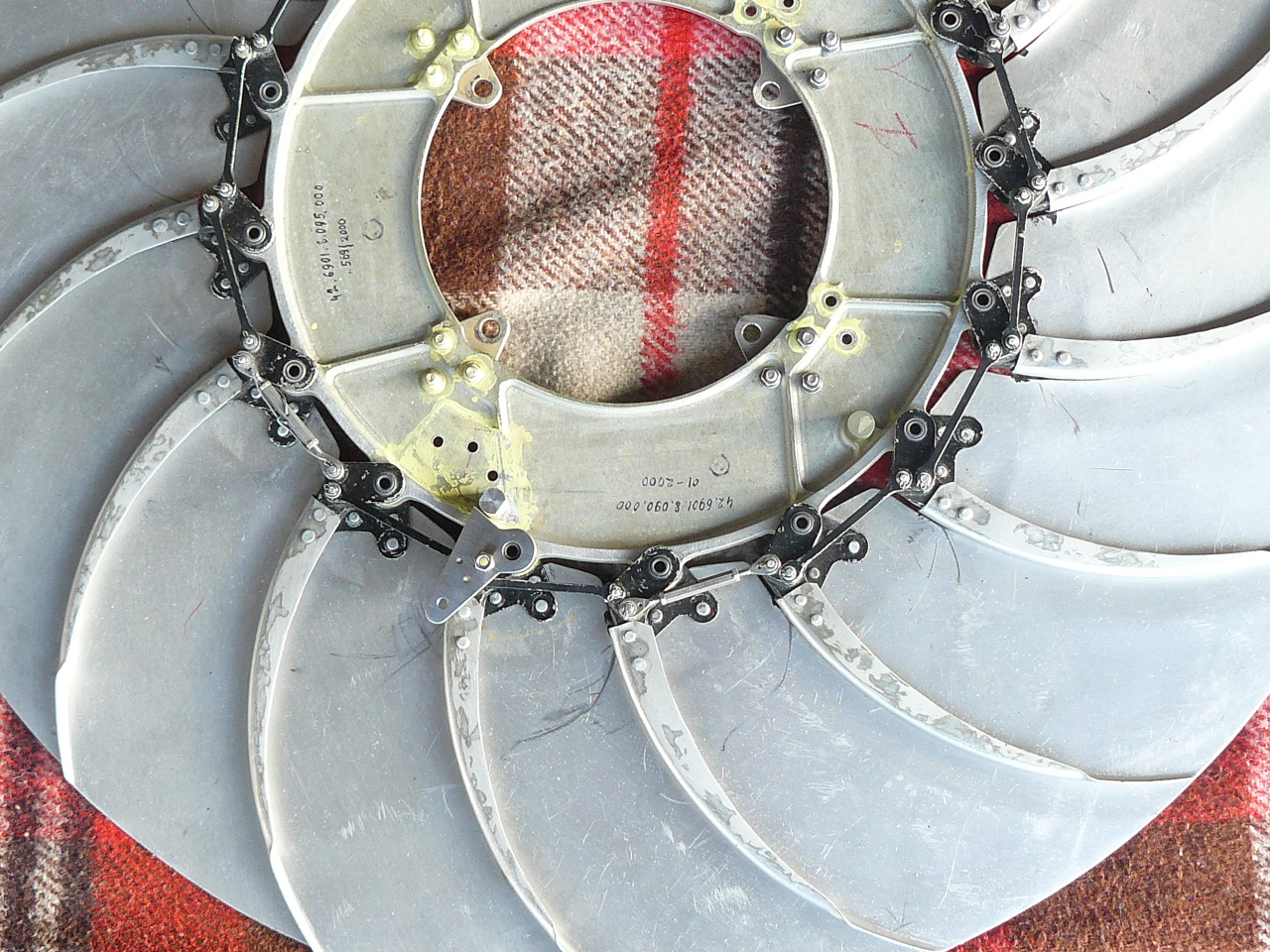

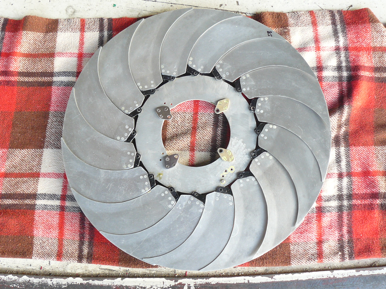

to be open, there are a few bits you have to work out from your side: Seems I did two new brackets to mount the iris to the engine, plus a new lever, see photo. I believe my shutters came from a Sukhoi but don“t know why there is a difference, variations of M 14 gearbox castings ?
Then you will design an extra mechanism for actuating the iris. The high friction prevented using the original push-pull cable in the 18 T, so I made up a twin pull bowden system with two cables and torque rod from fire wall to the iris, sorry, no photos at hand. Does anybody know how the system looks in a Sukhoi ? Maybe you will come up with something else, depending on conditions in your aircraft. At least you got the warning to know where problems might be and fabricate a good system from the start. I tried hydraulics first, but that was not quick and easy and had snags in detail as well.
