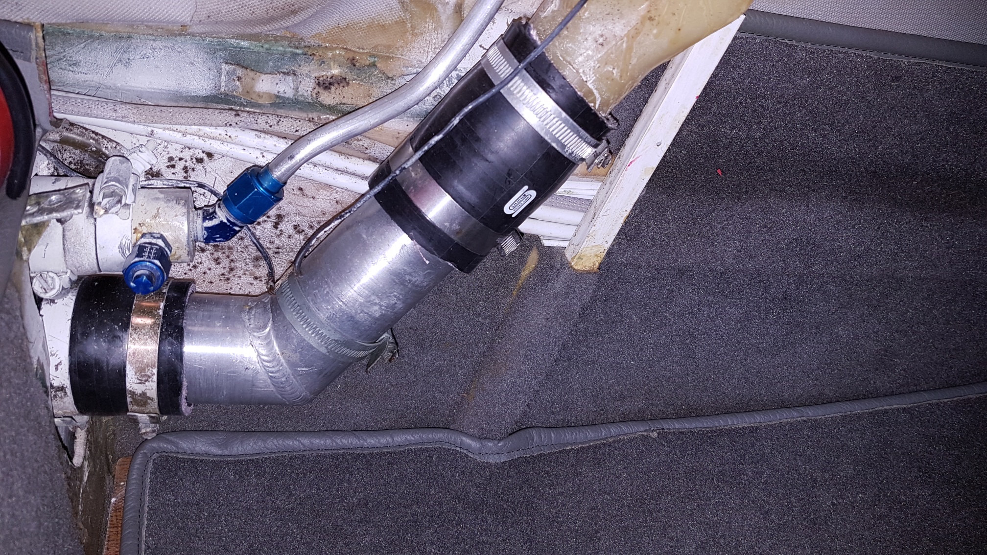

PostPosted: Mon Dec 18, 2017 3:03 am    Post subject: Re: Aluminium Elbow Reply with quote
Here is a pic of the elbow in place.
Carl

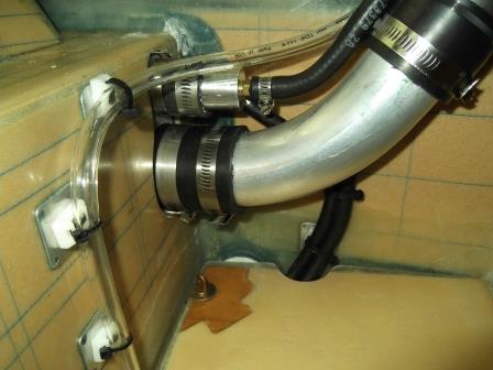

Hi All
Damn! Just fitted Tim's pipe and now it looks like I will have to remove and replace the rubber hose with something else, yet to be decided by the LAA.
Two steps forward and one back!
Picture attached - the pipe supplied by Tim is bent not welded.

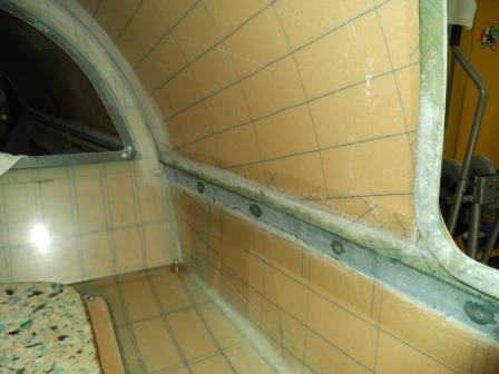

Out of curiosity, what are those lines visible in the composite, I suppose it's not a variety of peel ply ?

Hi Gilles
No, it's not peel ply. I think it is a tracer thread woven into the glass fabric to ensure the glass is laid up in the correct orientation during the moulding lay-up.
Here is a picture of the inside of the rear fuselage.
