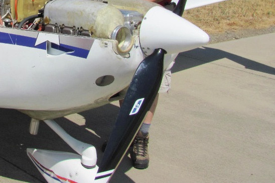

I had two HD lights in the cowl of my Jabiru powered Europa, but they turned out to be useless. I'd like to hear or see what others have done for a landing light and placement.
I recently installed a 40amp alternator and electrical power is no problem now that I got rid of the so called 15 amp Jabiru alternator.
AirEupora
Joined: 01 Nov 2009
Posts: 186
Location: Dixon, CA
PostPosted: Thu Nov 23, 2017 8:52 am    Post subject: Re: Looking for ideals on landing lights and placement Reply with quote
Here a picture of the ole landing light.

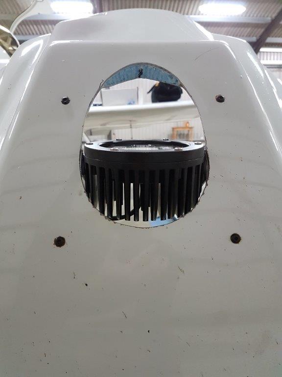

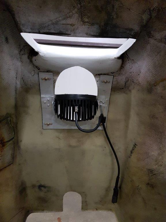

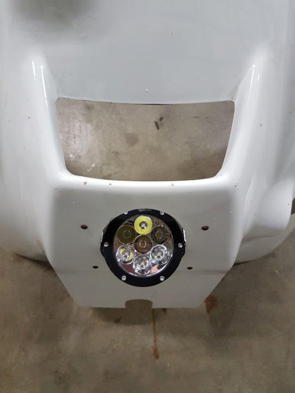

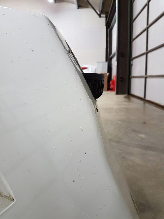

PostPosted: Mon Nov 27, 2017 6:07 am    Post subject: Re: Looking for ideals on landing lights and placement Reply with quote
Hi,
I fitted a 3846 Lumen 7 LED light in the cowl. It works a treat as a taxi tight and landing light, only pulls 2 Amps and has a 384 meter beam. It has been approved by the LAA. The light comes from Australia and is significantly cheaper than similar lights sold for aircraft. See https://www.jaycar.com.au/3486-lumen-ip68-solid-led-spot-light/p/SL3919
I've attached the doc I wrote that details the installation and a few pics.
Carl
