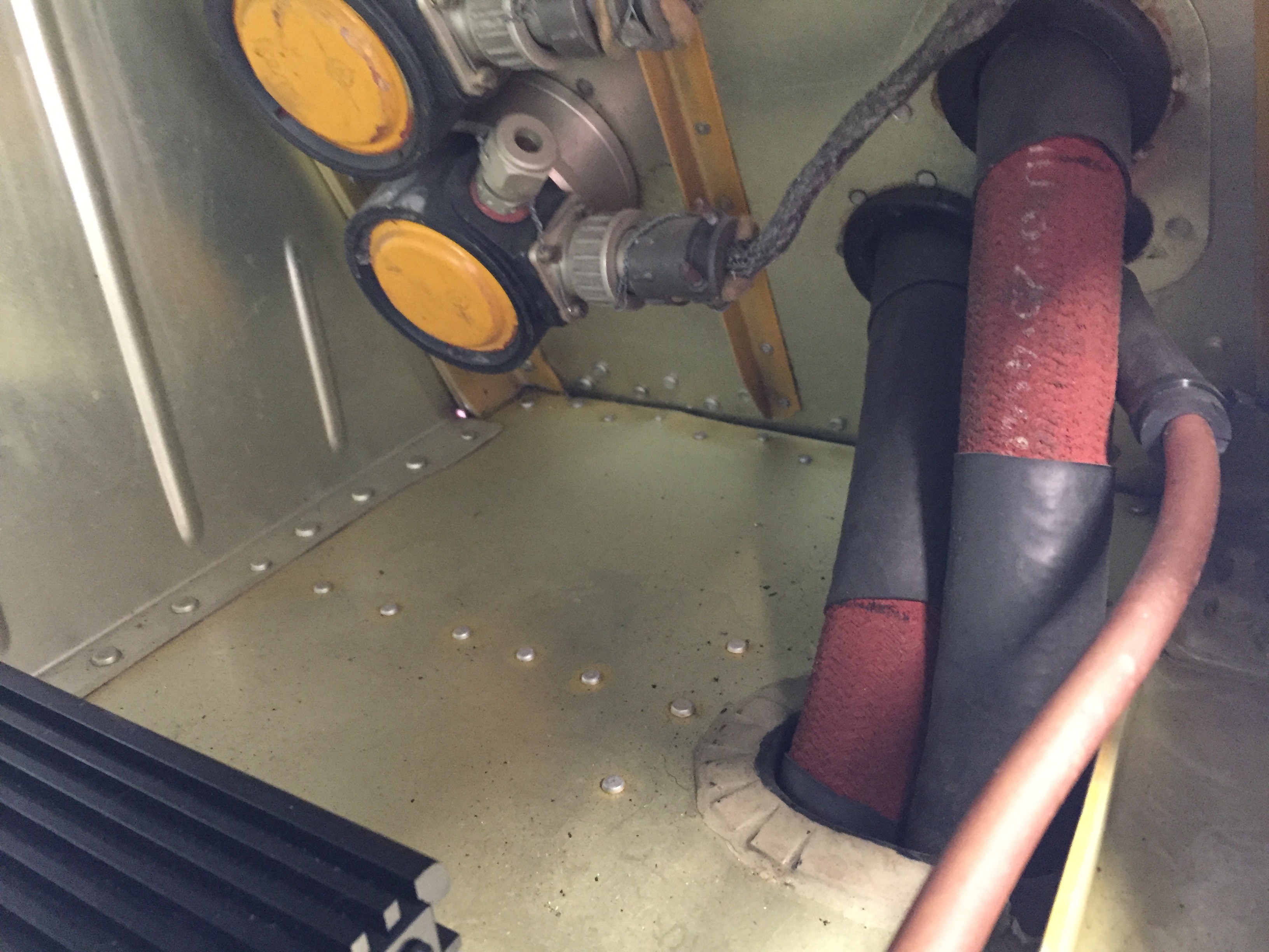

That certainly sounds like an electrical problem. A defective Cannon plug
is a very real possibility; either dirty contacts, broken wire making
intermittent contact, etc. Could be at the guage or the transmitter. The
oil press. transmitters (one for each cockpit) are mounted on frame 1. The
firewall is frame 0 and the FUEL press. transmitters are mounted on the aft
side of that- see photo. Oil press. units are the same but colour coded
brown rather than yellow. Sorry, no photo for those!
Check continuity to determine correct transmitter. Good luck.
Walt

PostPosted: Tue Aug 29, 2017 5:06 am    Post subject: Re: Housai Oil Pressure Reply with quote
Tom
Your CJ maybe like mine and the oil pressure senders are not located on the rear of the engine firewall but the secondary frame wall/cockpit area one.
The pic that Walt posted shows the approximate type and shape of the sender's but those I believe are the fuel ones and the oil senders (Transducers if you prefer) have a brown case covers.
On my aircraft they are located in the front cockpit and bolt through the panel (you may call is a secondary firewall or forward frame) just above the STB rudder pedal area.
Now its interesting you mention the issue you are having as my CJ oil pressure went exactly the same in the front cockpit and after alot of messing about I traced it to a faulty sender (swapping cannon plugs identified where the issue lay) which when opened up looked like it had been full of water??. I managed to rinse the muck out of it and clean up the delicate internals and it now works but I had to fabricate a new spring to return the potentiometer arm to zero.
Hope this helps.
