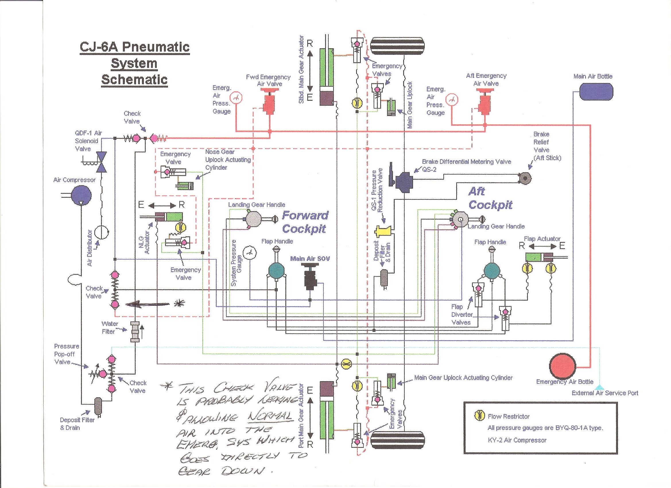

PostPosted: Mon Aug 21, 2017 5:39 pm    Post subject: gear retraction problem Reply with quote
Hi Bruno;
As Dennis and others have already suggested your problem is very likely a
check valve on the LH firewall that is leaking internally and allowing
normal operating system air pressure to pressurize the emergency system
which of course goes directly to Gear Down.
Not an unusual failure and, as Bob Schroeder noted, could be an indicator
of other moisture related problems as well.
See the attached schematic for location.
A good practice to avoid moisture related failure of course is to replace
your water filter innards on a regular basis. That periodicity will be
dependent to a large degree on relative humidity in your operating area.
Also a very good practice to check your brake system moisture trap (snot
valve) on a regular basis, preferably after every flight. If you find
moisture here your water filter servicing period is not adequate.
Walt

Hi ,
thank you for your advices.
we raise the plane and tested the gear retraction.
it was ok with the remaining air at 25 atm, we tested up and down 4 times till the air remains at about 10 atm.
it works well that is strange.....
i ve noticed an air leak inside the main corp of the front gear handle when gear up position,
perhaps the front gear handle to replace ?
what do you think about that Doug?
Best regards
Bruno
Fly safe
http://forums.matronics.com/viewtopic.php?p=472081#472081

PostPosted: Wed Aug 23, 2017 11:38 am    Post subject: Re: gear retraction problem Reply with quote
Hello again,
so I've made a flight this evening and the same problem appears again: after take off the gear do not retract.., visualy from outside, the main gear moved about 30° from vertical position. Gear handle was positionned down , 3 greens and land safely .
yesterday evening when acft was raised, I've done 4 test up/down and its look like good. pressure at the beginning was 25 and at the 4th 12 remaining .`
I do not test the emergency extension.
its is not possible to move the rear gear handle as the UK CAA blocked it as also for the Flaps rear handle.. (Im under UK registration)
this morning i refiled the air bottle at 45atm before this evening start up, i took off with 35 and landed also with about 35 atm
the QS2 valve isn't for the brake repartition?
thanks for help

PostPosted: Wed Aug 23, 2017 11:58 am    Post subject: gear retraction problem Reply with quote
Bruno,The correct p/n is QSF-2A of which there are three in your aircraft, both flap valves and the fwd gear valve.
You are correct the QS2 is the brake differential valve in the belly.
Doug

PostPosted: Wed Aug 23, 2017 12:38 pm    Post subject: gear retraction problem Reply with quote
Bruno-
Recommend you pull and check all 8 diverter valves (2 per gear and two for flap control) and rebuild or replace as necessary. Most likely your issue.

PostPosted: Thu Aug 24, 2017 5:02 am    Post subject: gear retraction problem Reply with quote
Sounds like the same issue I had... turned out to be main gear actuators. Doug Sapp rebuilt them and no problems since. JB

PostPosted: Thu Aug 24, 2017 5:21 am    Post subject: gear retraction problem Reply with quote
Hi again Bruno. As I anticipated you have a leak in the gear handle valve. Dismount and replace the O Ring inside. Simple as that.

PostPosted: Thu Aug 24, 2017 5:29 am    Post subject: gear retraction problem Reply with quote
Pedro,
I'm assuming you've disassembled a gear/flap selector valve beforesince
you said to replace the O-ring?
If Bruno hasn't tested the system the way I suggested, he may be just
spinning his wheels. ie: did he do a gear retraction test with the rear
gear selector (with the front in neutral of course) and was there air
leaking from the rear gear selectorwhen he did this test? If yes, the
problem is not the front gear selector.
Dennis

PostPosted: Thu Aug 24, 2017 5:56 am    Post subject: gear retraction problem Reply with quote
Hi,
The same for me on my YAK 52 in France few weeks ago.  Bruno DUCREUX fixed it the same way.
JP

PostPosted: Tue Aug 29, 2017 9:36 am    Post subject: Re: gear retraction problem Reply with quote
Bruno
I have the sister of your aircraft and of course served together in the PLA and also have the restricted rear gear and flap function as its a mandatory modification required by the UK CAA.
I would remove the rear cockpit gear restrictor plate and do the test Dennis has given as the will test both gear handle valves. It's good practice to excercise the rear cockpit one periodically, refit handle restrictor plate after tests.
Doug sells kits to rebuild the diverter valves and I did all mine when we brought the a/c onto the UK register. There was corrosion in about three of them so they were replaced and upgraded.
Good luck
