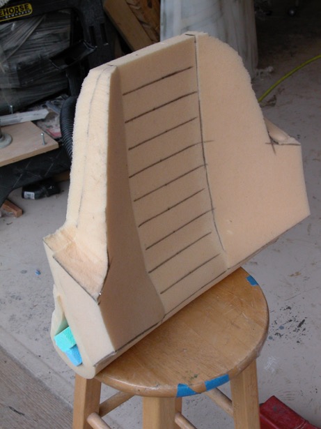

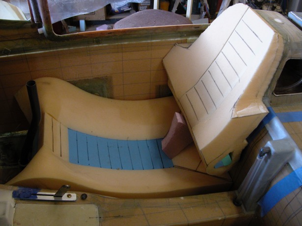

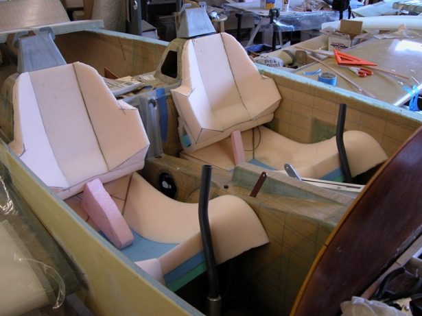

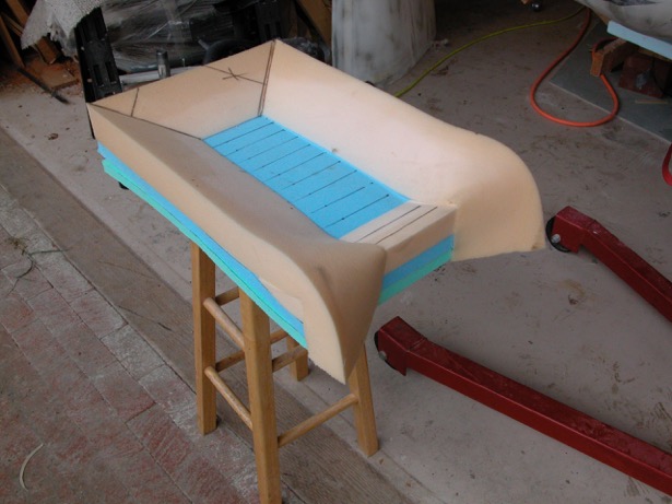

I've attached some pictures from Fred Klein's solution. The "Rolls Royce" of seats in my opinion. You can see the additional thigh support he has.

Fred Klein
Joined: 26 Mar 2012
Posts: 503
PostPosted: Wed Aug 16, 2017 2:00 pm    Post subject: Comfortable Cushions? Reply with quote
Cheeks, thigh and lower lumbar support guided my choices…seat w/ 1” green + 1” blue + foam wedges…
