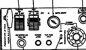

[img]cid:.0[/img]
The rocker switches have the same back-side
guts as the toggle switches sold by B&C and
made by Carling.

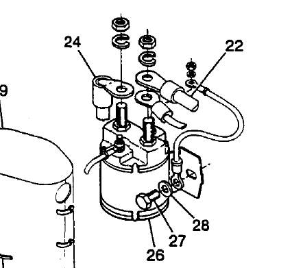

[img]cid:.1[/img]
I'm certain that this same constellation
of components persisted for a decade or
two after 1986.
The point is, there is a field history in both
hardware and architectures that makes our
job here on the List easier . . . it suggests
that we need not waste a lot of time hypothesizing
and mitigating every conceivable component failure
while concentrating on failure tolerant architectures.
Z-12 as published represents a well considered
and field proven solution to the single battery,
two-alternator option for a light airplane.
