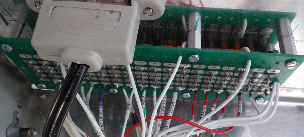

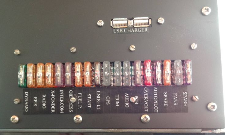

I purchased a Busman 14 fuse block. I did not like the density (fuses too far apart), the way the terminals protruded from the sides taking up panel space, and the way that the fuse sockets grip the fuses (weak grip).
So I made my own fuse block using a PCB and fuse clips. Search the web for "Keystone 3522".
My fuse holder has 18 fuses, 2 of which are spares. The wires exit straight out the back. The 8 small screws define the perimeter of the fuse block behind the panel. My rule is to never replace a fuse while flying and never with the master switch turned on. The fuse block is mounted in the lower right hand corner of the instrument panel in front of the passenger. The fuses glow when blown, except the 2 amp. Vans sells the glow fuses.

PostPosted: Thu Aug 10, 2017 2:20 am    Post subject: Fuse Blocks Reply with quote
Hi Joe,
Most interesting, congratulations !
I wish I could see the back of your fuseblock !
What did you use for the bus itself ? Metal strip, solid wire ?
Did you use Faston tabs to attach the wires ?
Best regards,
Gilles

PostPosted: Thu Aug 10, 2017 11:50 am    Post subject: Re: Fuse Blocks Reply with quote
Here you go Gilles, a picture of the rear of the fuse block. Do not let the reflection in the aluminum confuse. In the reflection, the wires can be seen making a 180 degree turn before being soldered to the PCB. No worry about stiff soldered wires breaking because they are no longer stiff where exiting through the holes in the board. The top 3 rows are one continuous copper PCB layer on both sides of the board. The solder mask hides the copper. The top 3 rows really are continuous. The main power bus is nothing more than the copper layers on the circuit board. I had considered soldering a 6 inch long #14 or #12 AWG wire along the bus to increase its capacity. I did not because my RV-12 only uses about 10 amps total. The #12 wire from the aircraft battery contactor is spliced to 4 each of 18 AWG wires that are soldered to the top row of the bus. The alternator (dynamo) is similarly connected with 4 of 18 AWG wires to the bottom of a 30 amp fuse (back fed to the bus). This fuse block has about an hour of Hobbs time. So far no problems.
 Filesize:  213.12 KB
 Viewed:  12908 Time(s)

gilles.thesee(at)free.fr
PostPosted: Fri Aug 11, 2017 6:36 am    Post subject: Fuse Blocks Reply with quote
Thank you Joe, you gave me ideas !
To everybody, how about installing ANL current limiters on a PCB ?
Along with the ATO fuses, of course.
If you're building a custom power distribution
center, consider the miniature ANL current
limiters like these . . . much smaller
and readily available.
http://tinyurl.com/y9427ggp

I imagine it is possible to solder screws through an extra thick PCB to hold those ANLs.
