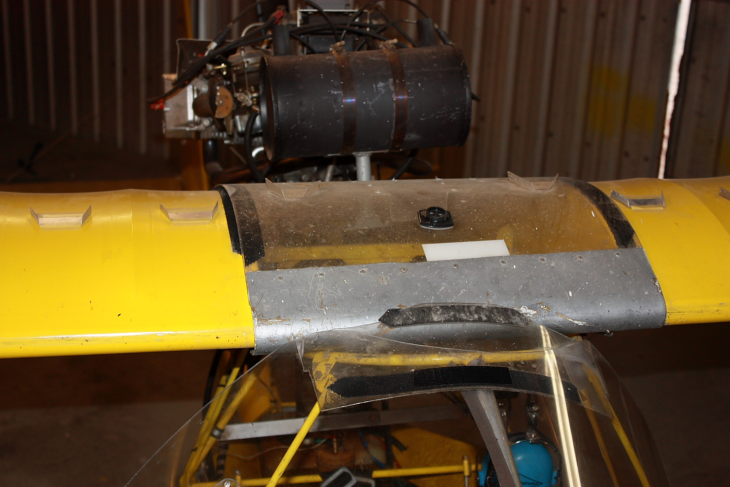

PostPosted: Tue Aug 08, 2017 3:22 pm    Post subject: Gap seal Reply with quote
Ideas to install gap seal.
I have a vls brs.    The tray for the brs is mounted to the motor mount tube...   I've riveted a  7/8 tube to the brs mounting plate...  As I built ribs for the gap seal they were built in a manner that I could rivet an internal brace to the 7/8 tube...    Then built a faring between the top of the windshield and bottom of the gap seal,  riveting in place....    The sides of the gap seal are 1/4 to 3/8 inches from the wings..
I can fold the wings without removing the gap seal.
Boyd Young

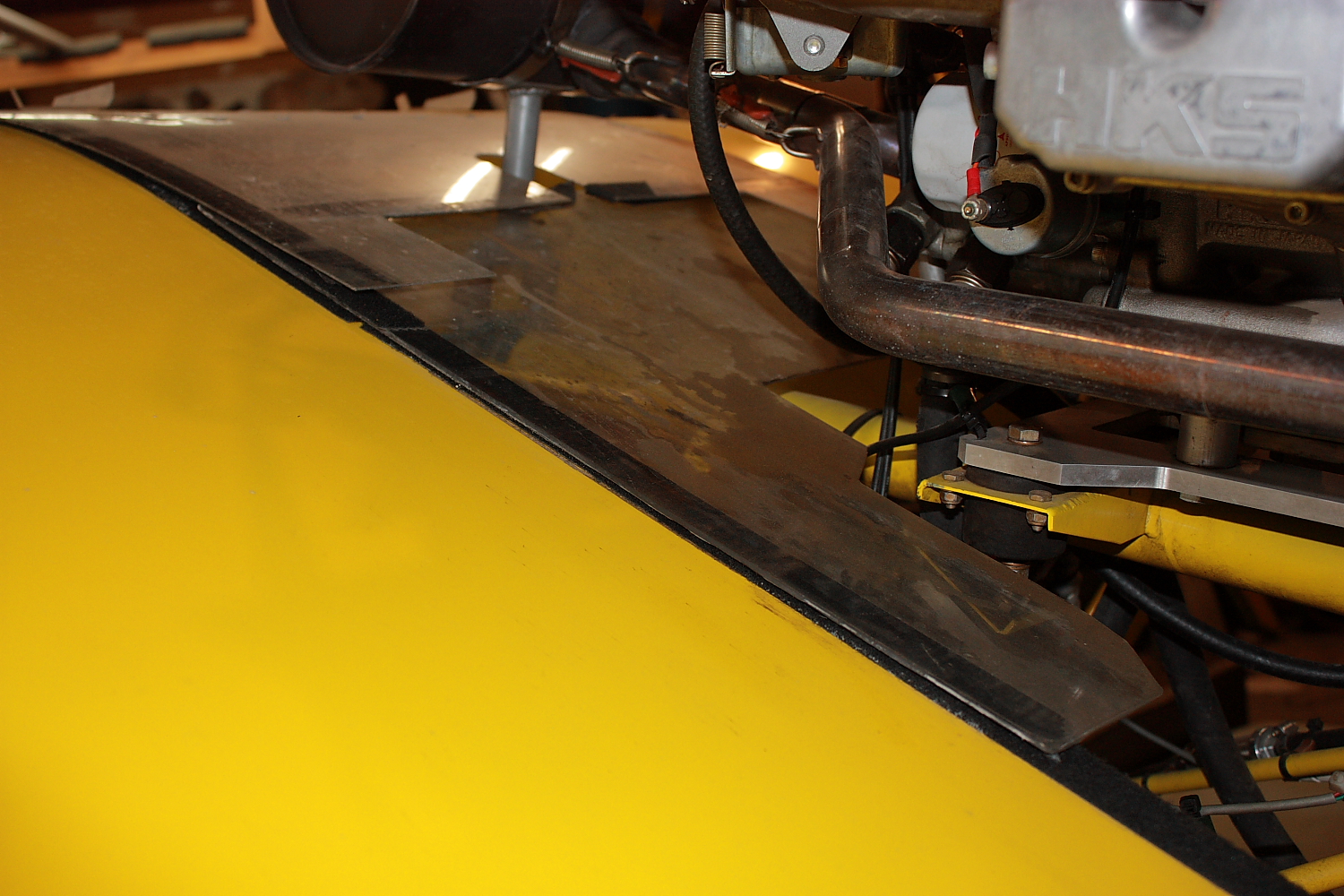

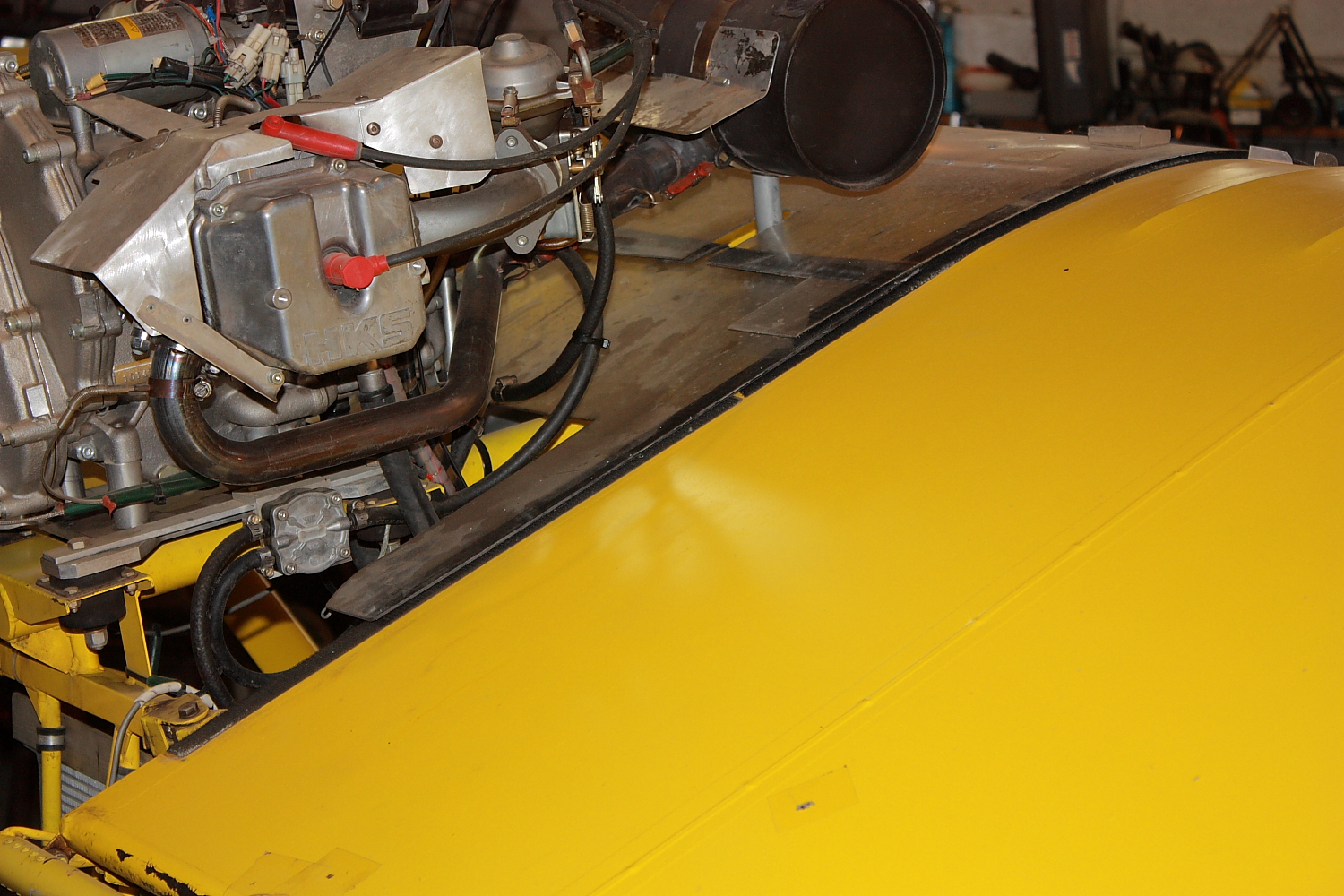

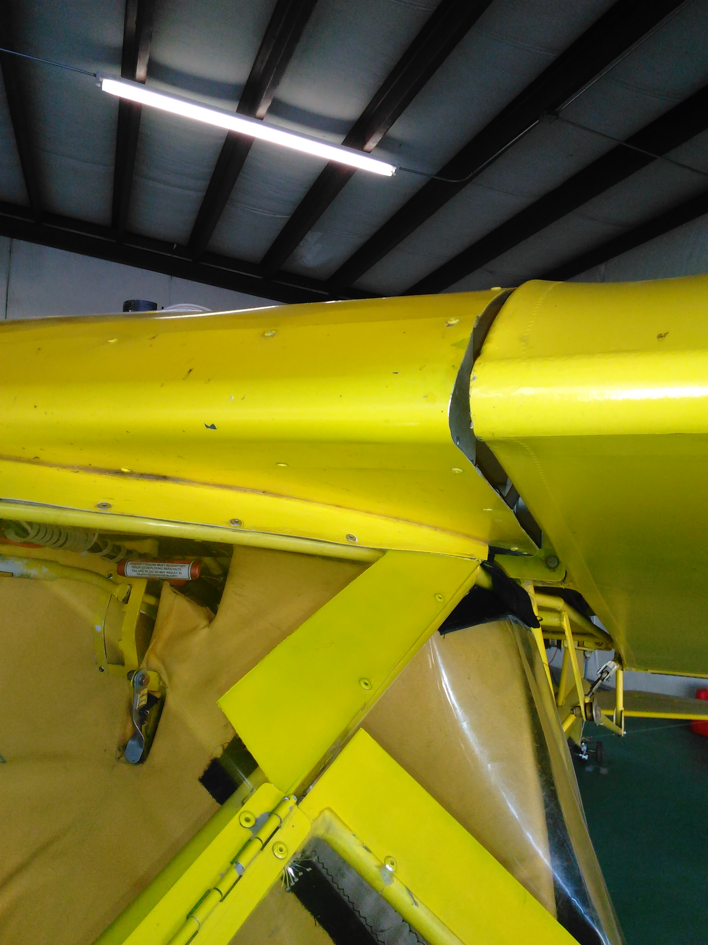

It would appear that Boyd and I are the only ones awake today. I purposely waited for someone smarter than myself to give you guidance. I suppose he is out flying.
I have seen three ways to do a gap seal. One is using the fabric that Kolb gives you. It works, but I never liked it.
The Mark III's all seem to build a solid gap seal such as described by Boyd. It works well, but I was either never smart enough to build one or too lazy. I couldn't say for sure which. It works well
The method that I used for my Firestar II is a bent tin front secured to a piece of lexan with a cut out for a motor or any thing else in the way such as my muffler. It is secured to the wings with velcro. When you take it off, just slide a towel or a piece of lexan or cardboard between the two pieces of velcro and lift it off..
Larry

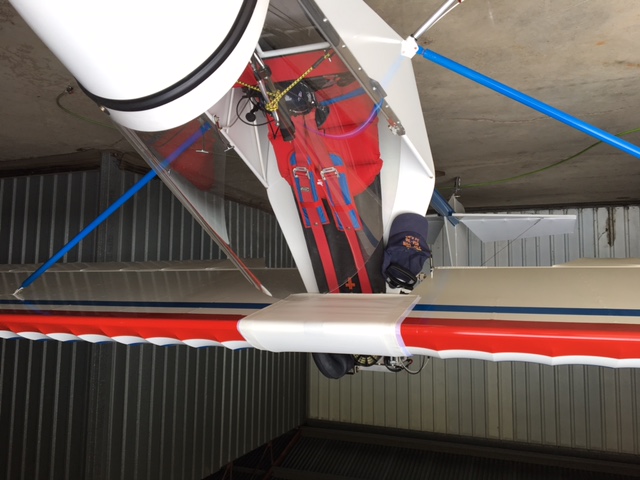

Brian Carpenter has come up with a great way to make gap seals from foam pool noodles. He pulls the noodles through a heated die.
https://electricmotorglider.com/2017/07/15/57-80-10-large-gap-seal/
The resulting foam shape fits snugly between the aileron tube and the trailing edge of the wing and completely fills in the profile of the wing shape between the trailing edge and the aileron.
I've also used a urethane tape designed for sealing gaps in doors and windows. I think I got it at Ace Hardware. It's slightly stretchy and very sticky. I've had it in place for over 5 years and none of it has fallen off. The gap on the airplane I have it on may be smaller than on the Kolb.

I tried making the noodle gap seals but because of the way Kolb ailerons are hinged they pop out.
Joe

They *look* like they would cause significantly increased control system drag, due to friction between/among the fixed & moving surfaces and the noodle. I guess that in some a/c designs, it might not be noticeable.
