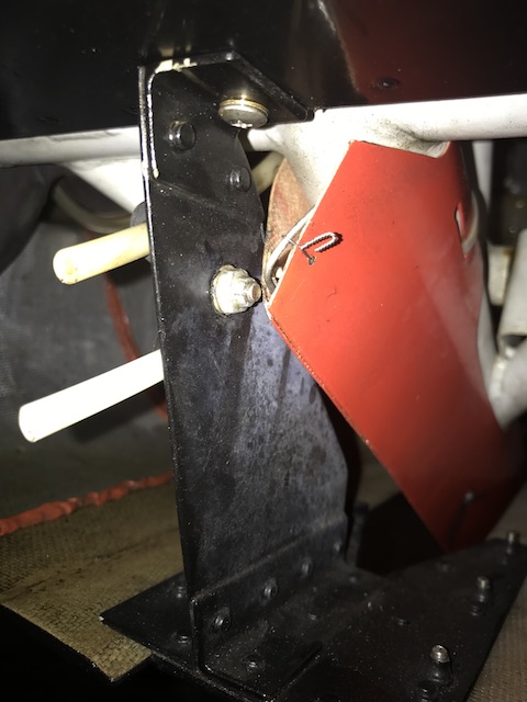

I had to make a new one, because my James cowl has a slightly taller exit area. Used a bit thicker aluminum and angles on both top and bottom. Much sturdier and so far no signs of issues in 280 hours. Here's a picture.
I also have camlocks on the bottom of the cowl, the floating ones too.
Lenny
What are the two lines adelled to the bracket?

Fuel pump overflow and FAB drain line.
