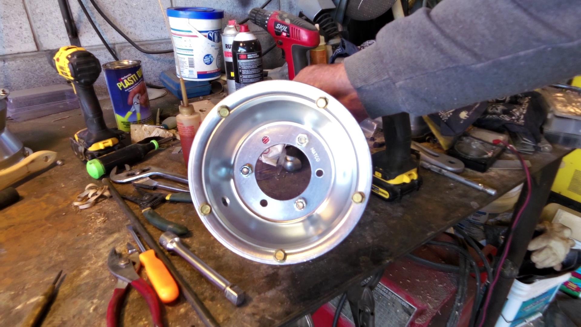

Today dawned cold, 22 degrees but calm for a change. It eventually
warmed up to 44 degrees and I went to the hanger to start my tire

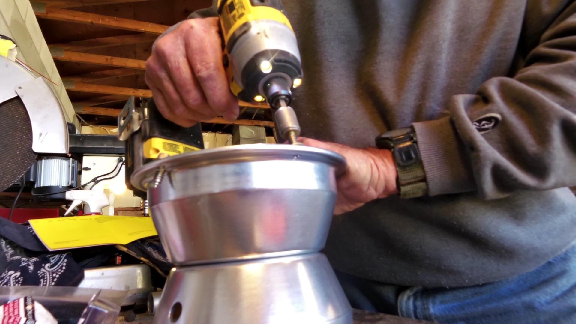

mounting. I drilled 6 holes in the rims to screw the tires to the
rims. The tires fit tight enough that it takes about 20 lbs of air to
make them pop out on the rims. That is unlike the Azusa rims that
depend on small flanges on the inside of the rims to keep them from
spinning. Since I want to run 5 lbs or less I am still not going to
take a chance on shearing off the valve stem, thus 6 screws per side.

I drilled and cut threads in the rims, and then mounted the tires.

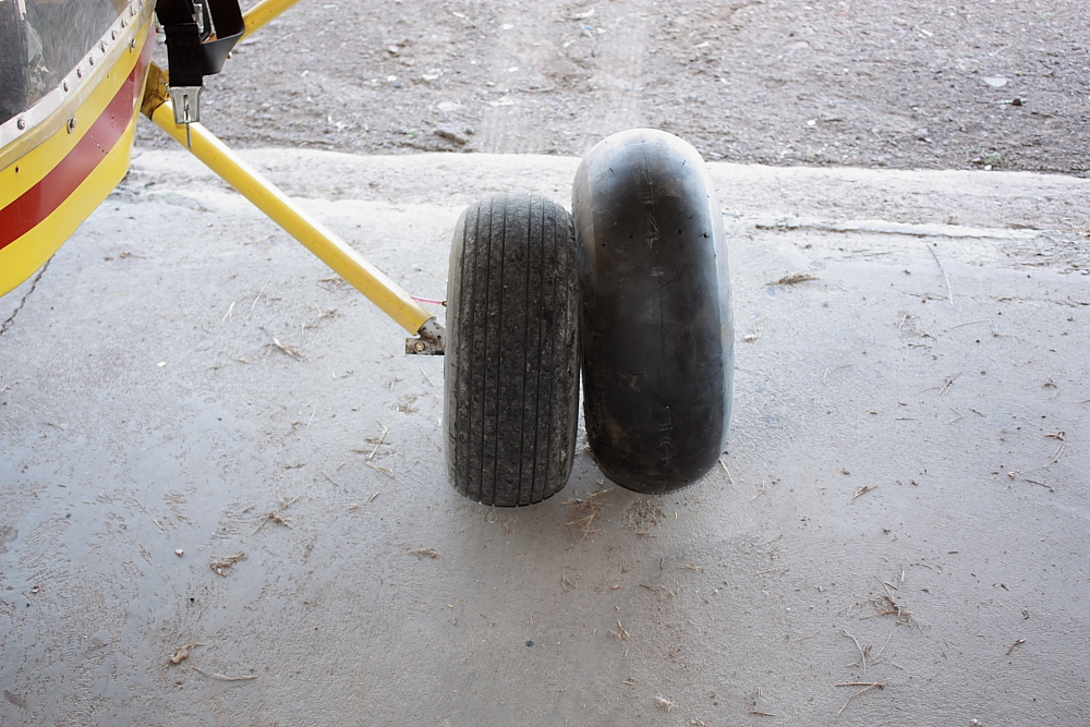

Since the 8.00 x 6 tires are on Matco rims as well, I just changed the
three bolts that held the bearings in the other tires and changed them
to the new tundras.

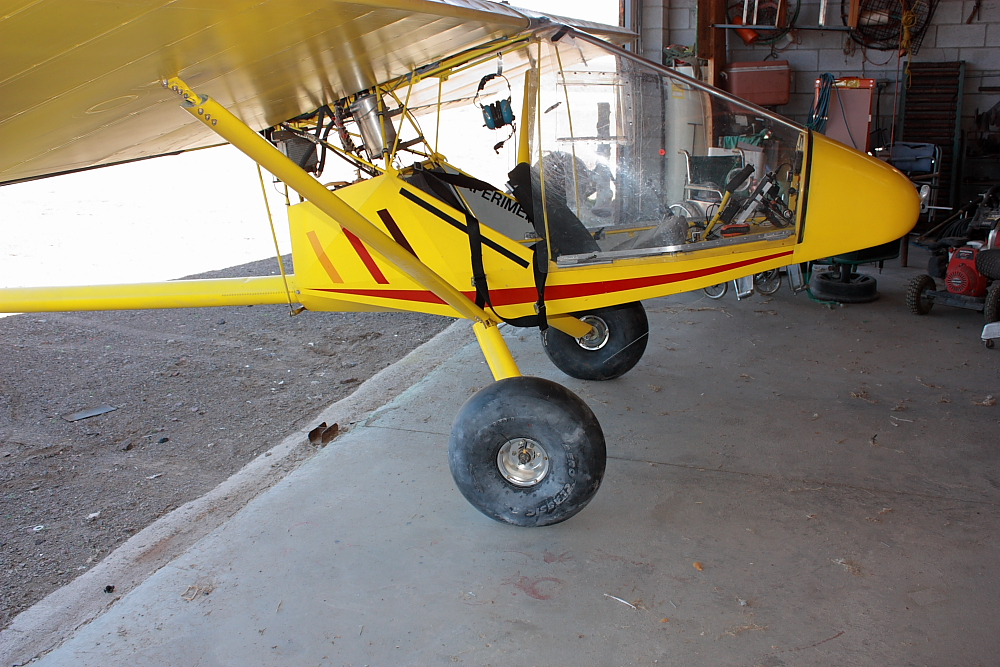

The wind was still holding its breath, so I rolled the plane back out
to check the difference. It seems to roll better with the tundra's on
it. I taxiied to the other end of the runway, and began my take off. I
cannot be sure, but the tires with 5 lbs of air, seemed to bounce a
bit on take off, but I could not be sure. When I pulled back on the
stick it flew quickly. I tend to push the stick forward to pick up
speed, so it could have been trying to fly, while I was pushing it
back on the ground. I will be doing a lot more testing when the
weather again cooperates. My take off seemed to be quite a bit shorter
than normal.
In essence there was no indication that my air speed suffered at all.
It was quite turbulent so I only made a circuit and half. While I
seemed to bounce a bit on take off, I bounced not at all on landing.
The tires at 5 lbs are really nice. They appear to not need balancing,
unlike the 8.00X6's.

Larry,
Are you using tubes in these tires? If so, how do you keep the screws from puncturing the tubes?
Just curious as I am happy with my Black Max brakes, tubeless tires and aluminum wheels on my Firefly. Apples and oranges, I know....
Stuart
lcottrell
Joined: 29 May 2006
Posts: 1494
Location: Jordan Valley, Or
PostPosted: Sat Apr 15, 2017 5:19 pm    Post subject: Baby's got some new shoes Reply with quote
You wrote: Are you using tubes in these tires? If so, how do you
Yes these are tube type tires. The screws don't go all the way through
the inside rim of the tire. The screws are 3/4, so I put a washer on
them and they are just right for length that way.
Larry
PostPosted: Sun Apr 16, 2017 3:27 pm    Post subject: Baby's got some new shoes Reply with quote
Sounds good.
Reckon sitting more nose high helped with your takeoff?
lcottrell
Joined: 29 May 2006
Posts: 1494
PostPosted: Sun Apr 16, 2017 3:53 pm    Post subject: Baby's got some new shoes Reply with quote
On Sun, Apr 16, 2017 at 5:27 PM, John Hauck <jhauck(at)elmore.rr.com> wrote:
Sounds good.
I think that it did, seems a lot shorter. I just went back and looked
at the video and as near as I can tell I lifted off at 34 MPH
indicated. Stall is 29-30 . With the taller tires it is sitting at the
angle that it is when it actually stalls, so it would appear to be at
optimum attitude.
I am experiencing some bouncing at the same time that it wants to fly.
Not sure if it is dribbling or, starting to bounce. Need more take
off's to tell. Actually an observer would be just the thing.
Larry
