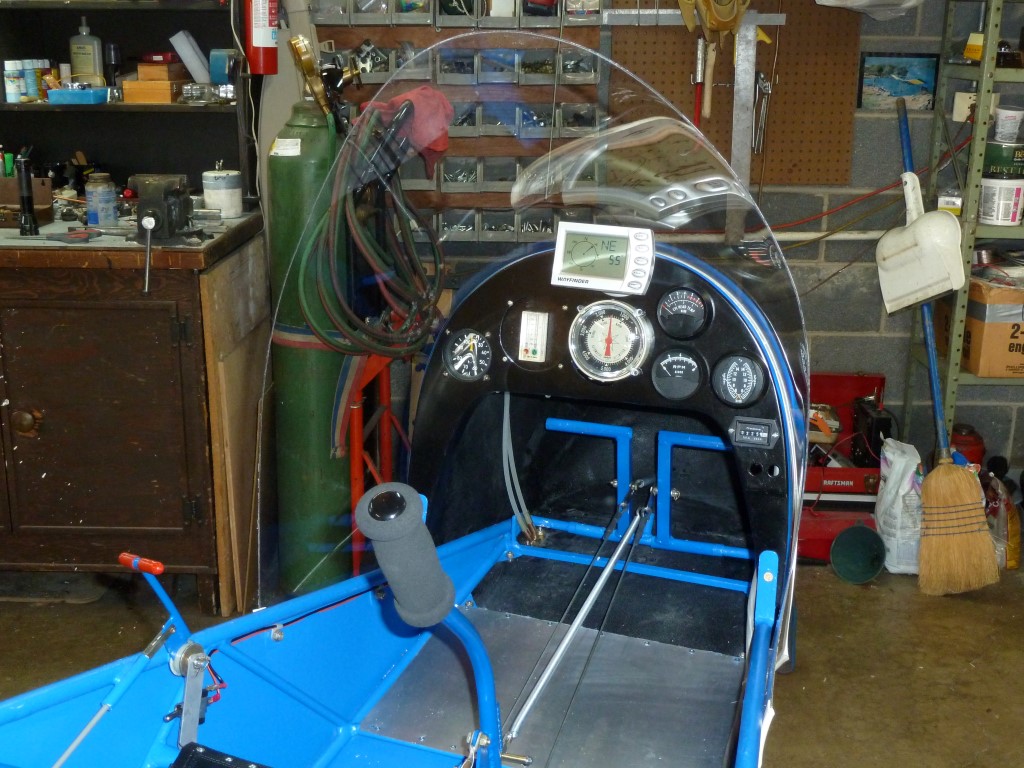

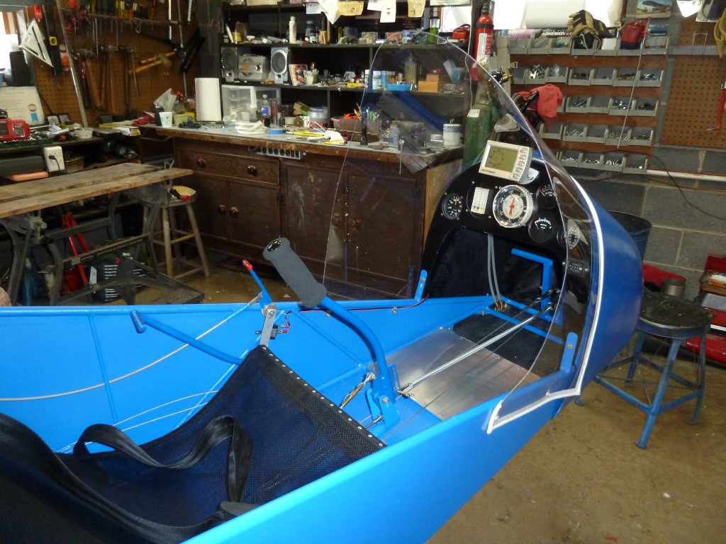

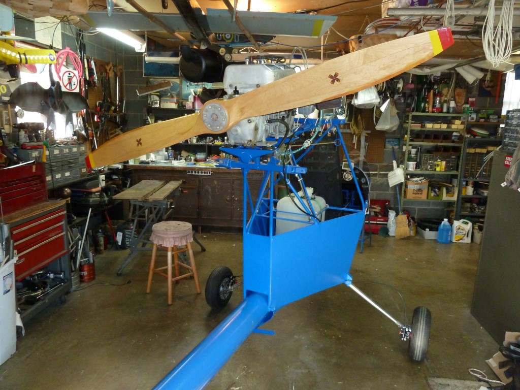

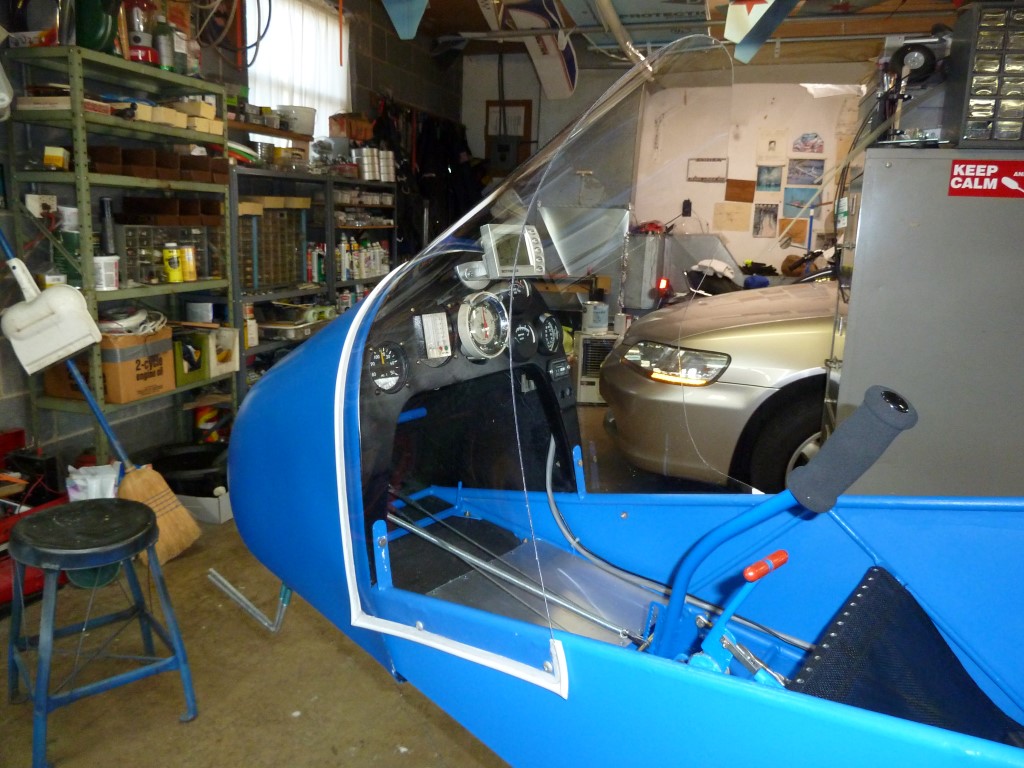

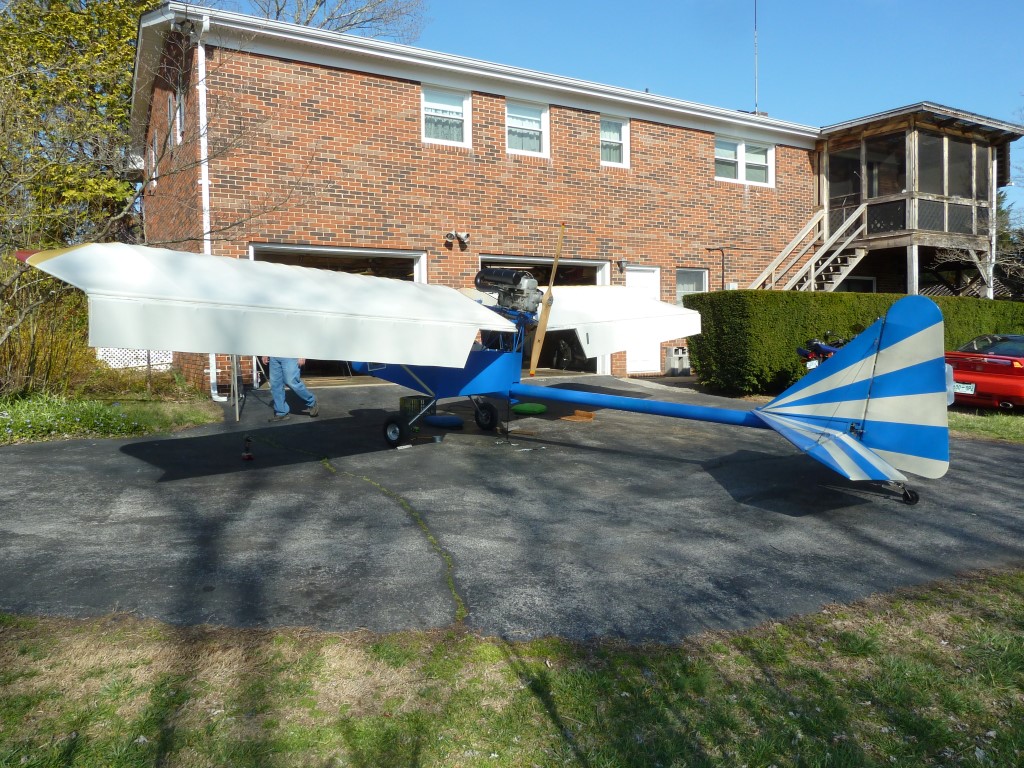

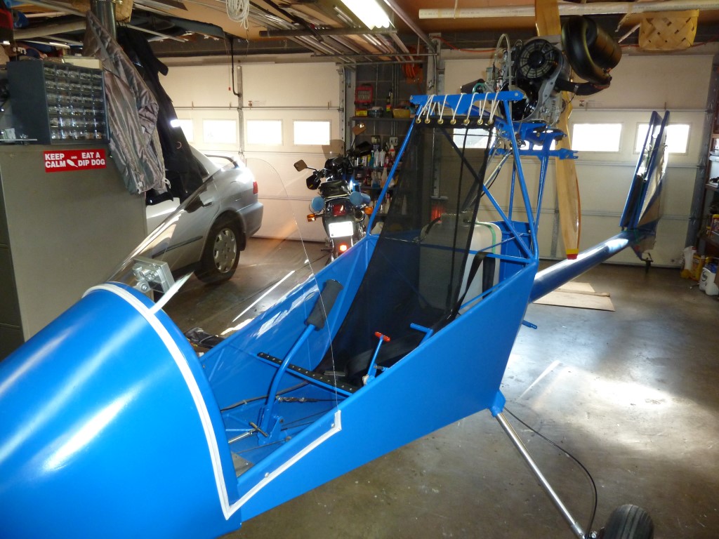

Since things are sort of slow on the list right now I thought I would do an update on the Firefly.
Got the windshield on today, the muffler and prop went on last week, and the wiring is done. David did most of the wiring; should have let him do all of it since he is much neater and better at it than I am.
Was planing to bring the wings home today but it is just too cold. Maybe Monday. Then start to put it all together. (Original Firestar wings, FSII wing struts, and a FF fuselage - what a mongrel!)

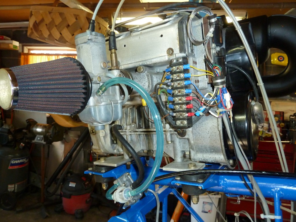

Yes, I know I am using blue urethane tubing between the carb and the fuel pump. That is so we can see if we are getting any fuel to the carb. Fortunately it is convenient to change every year. And those are the only conditions under which you should use that junk!

stuart(at)harnerfarm.net
PostPosted: Wed Mar 15, 2017 7:16 pm    Post subject: Firefly progress Reply with quote
Looking REALLY good!
What did you do to assure the screws will not come loose on the terminal
block mounted to the engine? Loctite or something?
You are going to have FUN with that plane!

PostPosted: Thu Mar 16, 2017 4:55 am    Post subject: Re: Firefly progress Reply with quote
S
Hm.. Glad you asked. Since they have been there since Bucky & Carl built it back in 1985, it hadn't occurred to me to wonder what is keeping them in. I'll check it out today. Thanks.

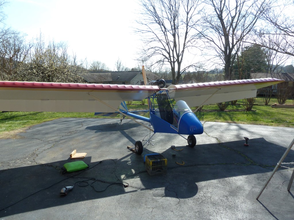

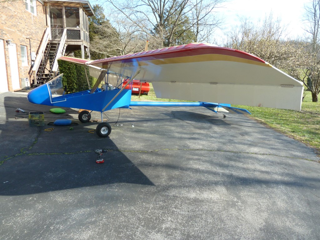

PostPosted: Thu Mar 23, 2017 5:18 pm    Post subject: Re: Firefly progress Reply with quote
Great day to be outside working on an airplane with your bud.

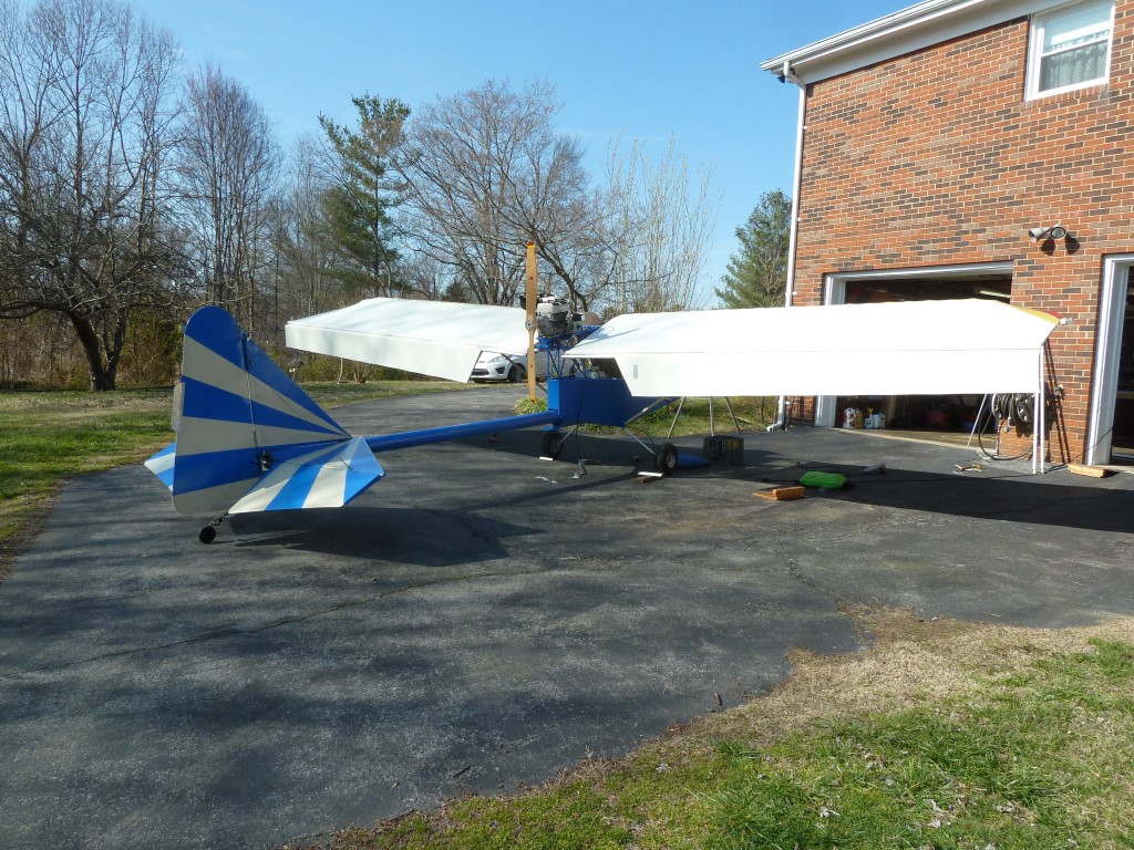

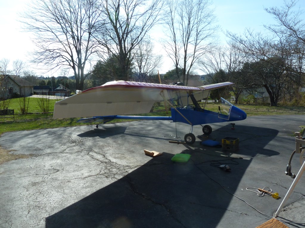

Replaced the one bent wing strut attachment tang yesterday, today we rolled it out and trial fitted the wings. Mostly pretty good, one alignment problem, tomorrow I can call Bryan at the factory and promise to send him money, and he will invent and send me the part I need to fix it.
Drug out the scales, maybe we might just barely be able to make Part 103. Right now it looks too close to call. Anybody got a good Hirth F-33 with redrive and electric start you want to trade for a good 447 with gearbox & prop?
Here is what a Firefly looks like when you build it out of 3 separate airplanes:

PostPosted: Fri Mar 24, 2017 1:21 am    Post subject: Re: Firefly progress Reply with quote
Looking good Richard. What did it weigh? I'm headed to Kolb this afternoon to pick up the parts for my project. Hopefully I can start assembling and fitting everything together next week.
Question...what is the position of the horizontal stabilizer to the boom tube? Drawing says 3/8" above tube. What is yours?

PostPosted: Fri Mar 24, 2017 4:57 am    Post subject: Firefly progress Reply with quote
Looking very good. Looks about like what I ended up with on my original 5 rib Firestar. No photos- I had to let it go. But you are right about weight- everything has to be trimmed and weighed. And mine had a main tube that was one foot shorter than standard. Speaking of which, has anyone heard from Jack Hart? He is the current master of that.

PostPosted: Fri Mar 24, 2017 7:51 am    Post subject: Re: Firefly progress Reply with quote
It weighs 274 on a very uncooperative and unreliable bathroom scale. Looks like we will be relying on that hand deployed parachute to make weight, even if it is no good for anything else. And the tail is 3/8" of an inch above the boom, because it is a recycled FSII tail and boom.

PostPosted: Sat Mar 25, 2017 4:54 pm    Post subject: Re: Firefly progress Reply with quote
Thanks Richard. From the pics, it looked more than 3/8". Picked up the new nose cone, tail brackets and fuel tanks today. Bryan and Helen were great to visit with. Saw some nice planes and ask a lot of questions, hopefully I can remember all of the answers.

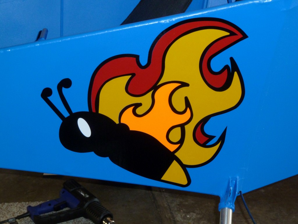

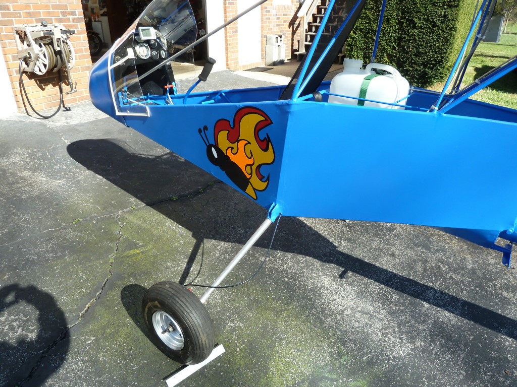

Now it is officially a FireFly. With a Shout Out to Andy who did it!

Very creative nose art Bro Pike!
