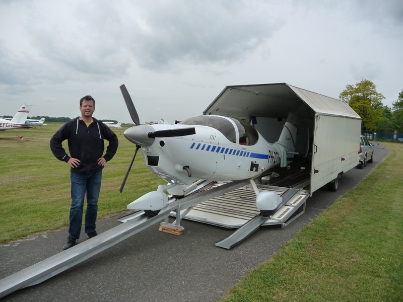

I've installed this one now (integrated also between spinner and cooling inlet - see picture): https://www.amazon.de/dp/B01MECTX01/ref=pe_386171_37038021_TE_3p_dp_1
My ACL http://thiesen-electronics.com/en/index.php?page=lichter/acl3.html (also LED) sits on top of the fuselage behind the tank breathing pipes.

Many thanks Roland. I admire your enclosed trailer to accommodate a tri-gear Europa. Perhaps I'll modify my old enclosed trailer which was built for a mono-wheel.
Jonathan

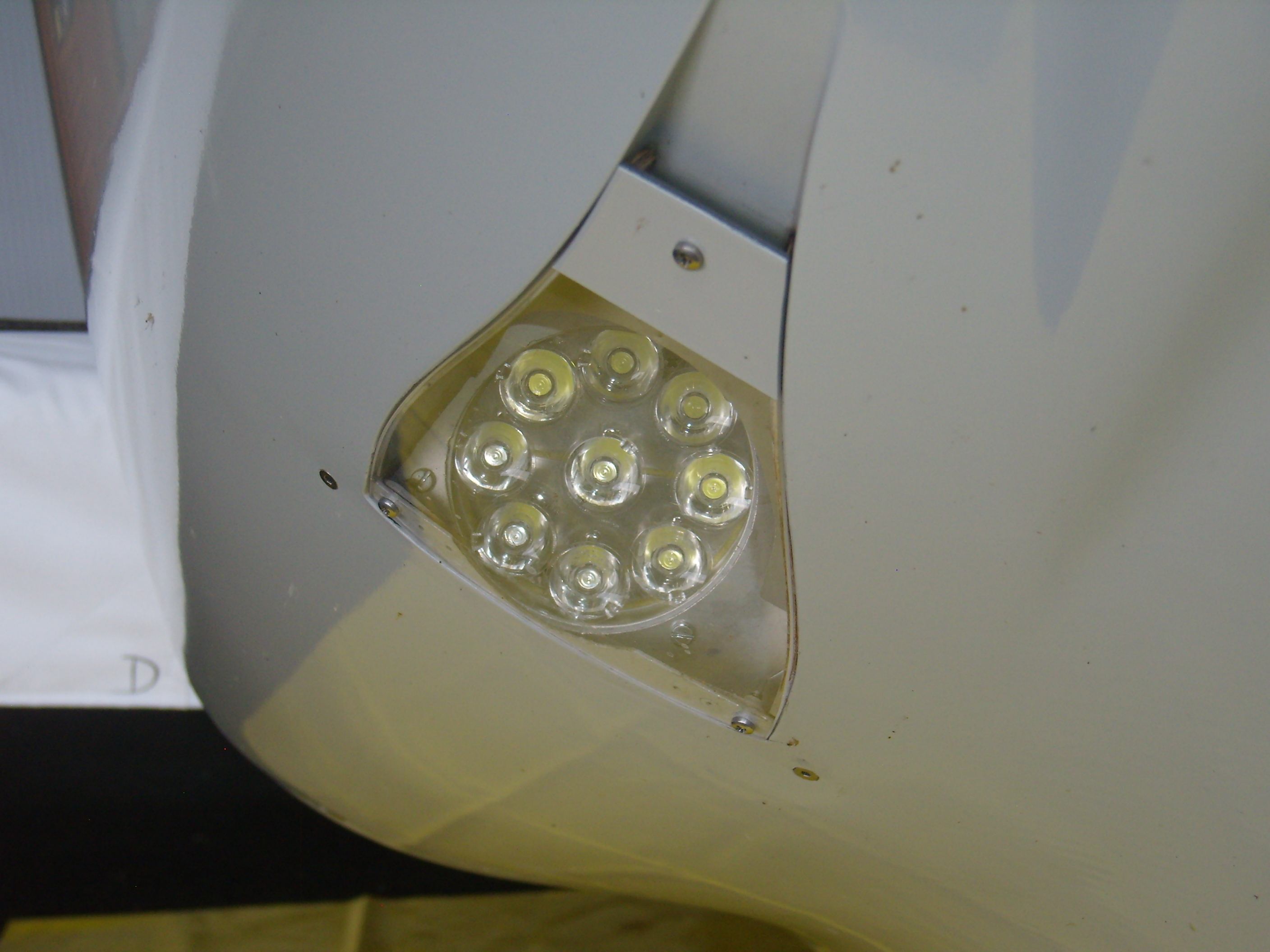

As most general aviation products come from the US and importing is very easy, deciding not to buy from them is a strange idea!
I have installed a Kuntzleman LTR LED light (US made, sorry!) in the lower starboard air intake (which is useful for 914 installations only). I turn it on all the time from take off to landing as long as I am below about 3000 ft AGL. Cost 234 US dollars. Works fine after 3 1/2 years and 300 flying hours. No interference.
Remi
