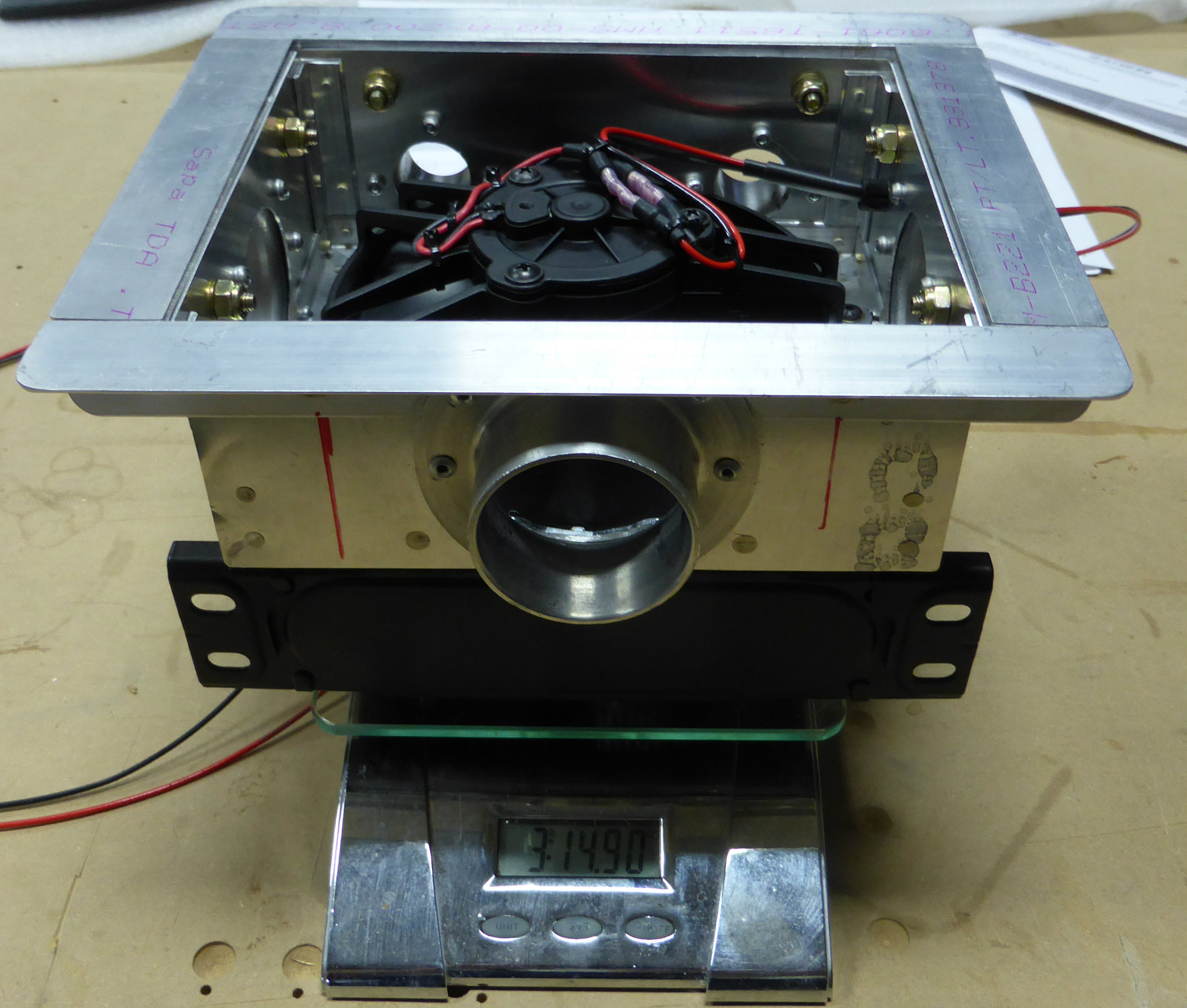

I am building a cabin heater (Rotax) and the fan draws 4.3 amps. I have read that on startup it can draw 12 amps. It is a permanent magnet type fan. It looks like a large computer fan on steroids.
I have decided to use my "defrost" circuit, which was originally going to power a couple of small, low draw computer fans. I wired it with 20 AWG wire.
I would like to use the existing wiring for the fan, but I might need to put in a 12 amp fuse, and am a little concerned that might be too much for the 20 AWG wire.
The wire from the bus to the switch is about 18 inches and the wire from the switch to the fan is about 24 inches.
I guess I have two questions:
1. What would be the largest fuse I could use and still be safe?
2. If I test it and it doesn't blow a 5 amp (or 7.5 amp) fuse, do you think it would be likely to continue working indefinitely?
Ken

That's a really sturdy looking fan box. Smile What's it weigh?

Charlie, it weighs 3 pounds 14 ounces, but that does not include hoses or fittings (or the additional fluid required). I estimate 5.5 pounds all told, 6 pounds maximum. The stuff that I will be removing (heater box, scat tubing, cables, etc. weighs about 3 pounds, so 2 or 3 pounds heavier the airplane will be.
To me this is a no-brainer, as I look upon the typical method of scavenging off the exhaust as a kind of Sword of Damocles, always poised to kill you. Plus, I live in Alaska! Lots of cold weather flying, so a better heater is really appreciated.
So anyway, I got my speed control this morning. I hooked it all up and tried to blow the 5 amp fuse. I was not successful.
I am thinking that maybe the information that I read about 12 amp startup draw is bogus. As I said, this is a permanent magnet type motor, very similar to what I have seen on computers. Does this type of motor really have large startup loads?
So now that I have tried and failed to blow the 5 amp fuse, unless this list implores me to rewire for safety, I will stick with the 20 AWG.
I'm pretty sure Bob has said that there is no problem using a 7.5 amp fuse with 20 AWG, right? If I did blow the 5 amp, I would still have the 7.5 amp fuse option.
