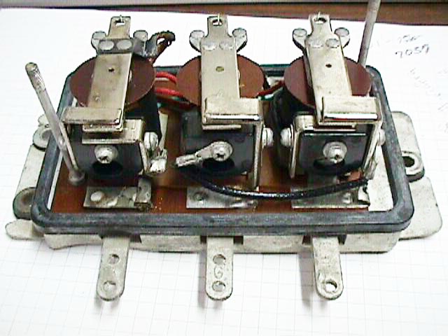

A bit of history:
The first electrical systems to be installed on aircraft
used generators . . . just like the ones on cars, tractors
and trucks. These were simply shunt wound, DC MOTORS being
PUSHED with mechanical energy into the shaft such that they
became GENERATORS.
They required rather sophisticated regulators that not
only maintained the target bus voltage but limited
output current (to prevent commutator and armature
over-heat) and provided reverse current disconnect
so that a NON rotating generator did not revert to
it's roots as a motor and run the battery down after
the engine stopped. These electro-mechanical analogs
to modern electronics are exceedingly clever creations
of the era.

Generators were self-exciting (meaning that they would come
on line with a simple input of mechanical energy (engine running)
and flipping the field supply switch to ON. Further, they
would run well without a battery on line.
Modern starter-generators on turbine aircraft retain traits
of their ancestors and they too run well without having a
battery on line.
Hence, aircraft with any form of generator will generally
have BOTH battery master and generator control switches.
Interestingly enough, the Beech Bonanza STILL has independent
BATTERY and ALTERNATOR switches . . . which is another
story.

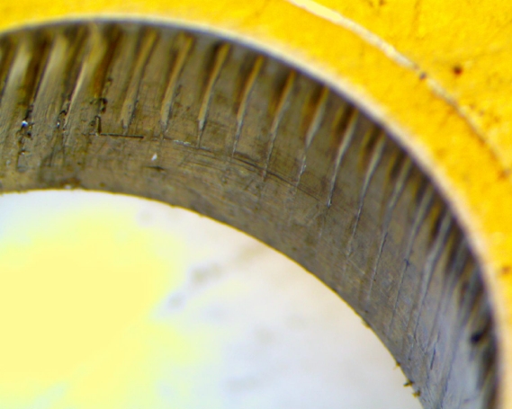

PostPosted: Wed Mar 08, 2017 9:15 am    Post subject: Z-17 battery/ alternator switch Reply with quote
The author explained that aeroplane alternators seem have a higher rate of failure compared to motor vehicle alternators that are also more commonly subjected to mud, water and dust ingress. His reasoning was that in a car the alternator field is isolated during the start sequence (as are the lights and most other power hungry devices that add to the battery load) until the key is released to its normal position. By contrast, when cranking an aeroplane engine with the alternator field excited, the voltage regulator senses a substantial sag in bus voltage and attempts to draw max output from the alternator to fix the problem before the alternator has sufficient RPM to provide the required output. I reasoned that this was why some manufacturers have split or separate alternator switches. Any truth to this concept then?
"higher rates of failure" is not very descriptive
of cause and effect. While it's true that some
alternators in aircraft have been problematic,
most of my encounters have been grounded in
design or manufacturing defect. We used to break
a lot of brackets on some installations. Piper's
love affair with the Chrysler 'pancake' alternators
led to short service life on attach brackets. An
alternator I conducted failure analysis on a
few months back had press fit diodes pushed into
oversized holes at odd angles using a hand-tool
as opposed to the recommended hydraulic press.
[img]cid:.0[/img]
The diodes were deprived of good heat sinking and in
some cases, good electrical conductivity.
The last task I mounted in TC aviation concerned alternators
that wouldn't stay on line . . . a problem I'd worked at
least two previous times over 30 years. Focus
of the investigation was on alternators that had
demonstrated problems over the years, but in this case
it was the regulator's o.v. sense system that was
overly sensitive to normal brush noise from this
alternator . . . they struggled for weeks to "filter"
the field leads (with limited success) while in fact,
it was the regulator that needed to be changed out.
At the same time, alternators supplied by B&C (and
no doubt others) have an exceedingly low return
rate.
The hypothesis offered in the article is without
foundation in physics or practice. If the author
went to the lab, he would not be able to reproduce
a failure by duplication of conditions cited in the
hypothesis.
It's all physics. For every failure there IS a
combination of conditions leading up to that failure.
Proper operations of switches by crew are exceedingly
unlikely to be in the chorus of conditions. Joe is
correct, a few seconds of full-field operation is
of no particular hardship on an alternator.
