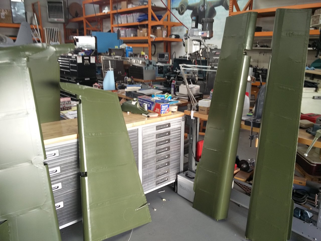

I just finished STITS from Aircraft Spruce, and it cost about $750 including the PolyTone "paint" (which was almost the most expensive part). Here is what I initially bought:

I ran out of Poly-Tak and Ply-Spray and had to borrow some from a friend. Didn't use ANY of the needles except the straight one. Lots of tape, thread and reducer left.
I then bought a gallon of the Poly-Tone (clear) and had it tinted locally to match the Chinese Olive Drab - fairly good match. Didn't try to paint the underside different. Still have 1/2 gallon of the clear Polytone left, as I only mixed up a couple quarts of color.
I had never done this before, and it took about 3 weeks of afternoons... I'm fairly satisfied with the job, but I got progressively better. Next time would be almost professional. I'm pretty sure it is safe. Smile
Attached is a pic of them - didn't get the elevators in there very well.
Hope this helps.
Stephen

They look good Stephen. It is not rocket science. Pretty easy once you get going.
