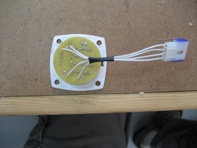

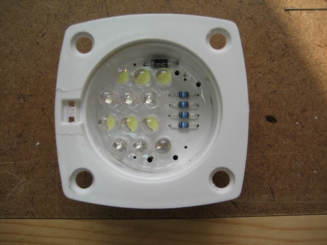

For map lighting, I went with one of these.
http://www.aircraftspruce.com/catalog/pspages/754cockpitlights.php
Black with 4 white LED's.
For cabin lighting, I used Perko lights. They are the lights that many Velocity builders use (available at West Marine and other marine supply stores).
http://www.perko.com/catalog/lighting_fixtures/708/incandescent_light_with_snap_on_front_cover/
But since I have a 28v electrical system, I made some changes. I removed the incandescent light and installed a set of blue and white LED's. Then I put in SPDT switches to select between Off, white and blue lights.

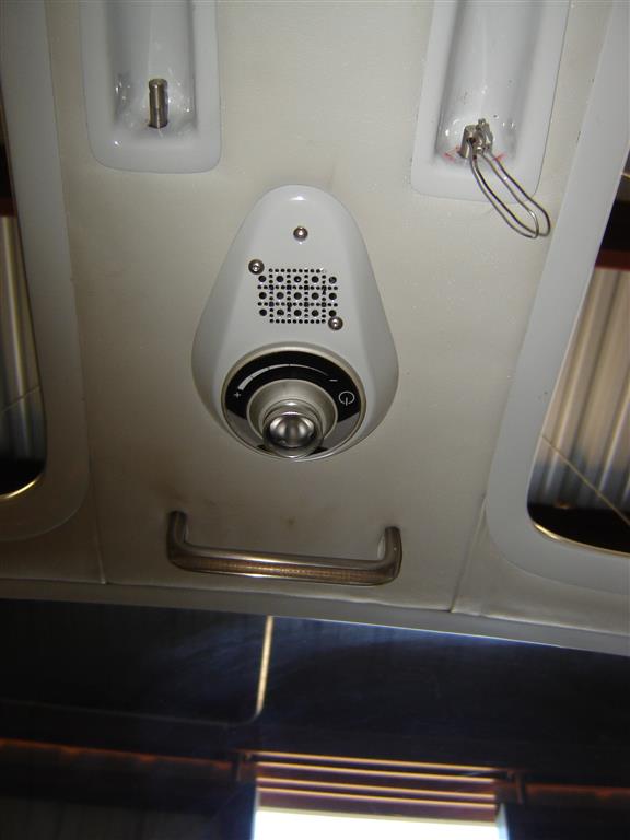

I used an AVEO EyeBeam-mini in my Glasair. A bit pricy, but the design is beautiful and functional. The eyeball lets you put light wherever you need it and it has capacitive integral switch/dimmer/red light.
I had/have an interference problem with my specific installation that AVEO engineers had never encountered. When I key my mike, the light starts flashing and the capacitive on/off switch becomes in op until power is physically disconnected. After unsuccessful attempts to fix it with ferrite toroids, I installed a small on/off/dimmer switch on the housing and in the power feed to fix it.
