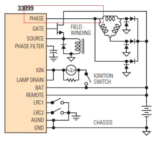

PostPosted: Sun Jan 08, 2017 8:53 pm    Post subject: Hot alternator Reply with quote
At 07:57 AM 1/8/2017, you wrote:
--> AeroElectric-List message posted by: Carlos Trigo <trigo(at)mail.telepac.pt>
Ken
Mine is also internally regulated but is an all new PlanePower 60A
Many, if not MOST internally regulated alternators
are fitted with a stator phase sense connection to the
regulator chip.
[img]cid:.0[/img]
This signal tells the regulator whether or not
the alternator is rotating so as to prevent
full-fielding of the alternator is a quiescent
state.
  regulator chip.
<323e6d5.jpg>
  state.
  No such provisions are available for most
  externally regulated alternators. Waaay back when,
  automotive alternators had a "AUX" teerminal
  that power the field control relay inside the
  regulator. This too effected field current shutdown
  while not rotating.
