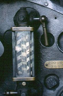

Might I suggest another solution. The standard sight gauges for the water level in boilers use a background with angled black and white stripes. Due to refraction, where there is liquid the stripes are reversed which makes it very easy to see the level.
I poked around on Google Images and found one example on a steam locomotive. Simple, effective, cheap and it will work with gasoline. See below.
[img]cid:part1.46B7B59B.83F08B46(at)windstream.net[/img]
Cheers, John

Hi John, Martin.
This idea can be found on page 3-4 of the build manual.
No need to reinvent it
Tim
