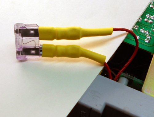

Needed to add a fuse to a device with limited
space and very low current requirements. Wound
up adding this ATC3 fuse to the gizmo using fast-ons
and heat shrink. While not as robust as a legacy
fuse-holder, the manner in which terminals are
retained in the ATC fuse doesn't raise much concern
for over stressing them with direct support
of 22AWG wire.

That is a really frugal solution, fraught with simplicity and lightness!
