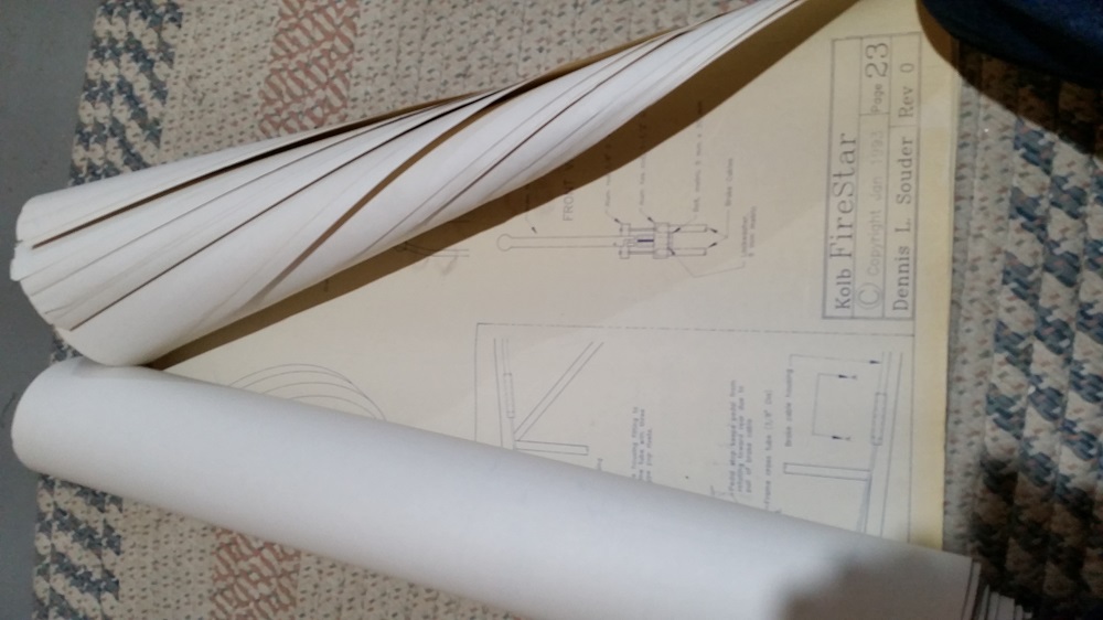

PostPosted: Sun Jul 03, 2016 4:20 am    Post subject: Re: Firestar cage Reply with quote
I am a long way from TN but I also have a slightly bent cage, wings, tail feathers , nose (not too bad shape) and a 5 pound roll of blueprints.
Firestar prints
 Filesize:  129.38 KB
 Viewed:  15805 Time(s)
West1m
Hastings, MN
Richard Pike
Posts: 1671
PostPosted: Sun Jul 03, 2016 12:05 pm    Post subject: Re: Firestar cage Reply with quote
Thanks. Let me see what we have to work with after I go collect what Herb has.
Richard Pike
