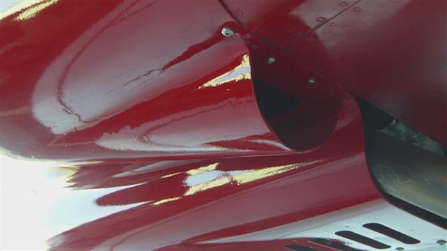

I added another opening on each side to improve oil cooling. I also have an additional oil cooler. Seems to be good enough now for Yuma's hot, hot weather.
Albert Gardner
RV-10 N991RV
Yuma, AZ
