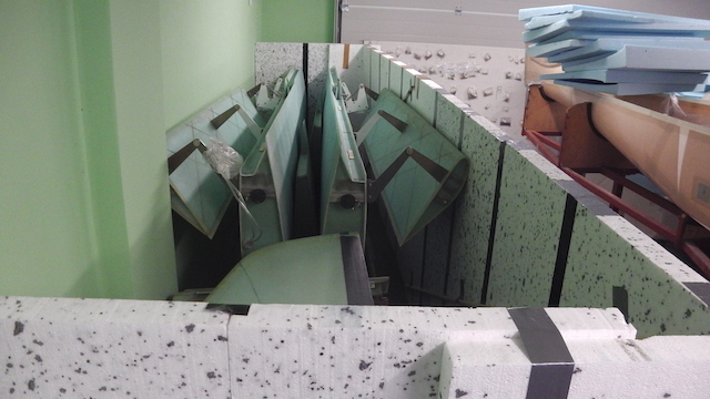

I was originally daunted by this but it's actually easy.  I bought some 1mx1m expanded polystyrene and built box/oven 1 x 1 x 2.    this was enough for my foam  flying surfaces flaps, horizontal stab, ailerons.
I used ordinary fan heaters inside the oven and removed the standard thermostat and replaced it with a thermostat from Aircraft spruce calibrated to 40C i think.
I but a baffle in front of the of the fan to ensure that there was no local concentration of heat.
I used a couple of meat thermomenters punched through the polystyrene to monitor the temperature.
Once i worked it out it was a couple of hours to do the job.

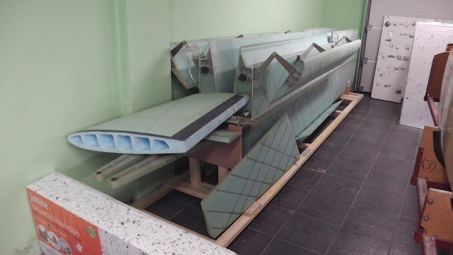

Tony my hot box was big enough to take the complete classic wing. I did
three sessions, one for each wing and one for all the other bits.
Pete

Tony you can find a pic of my oven in the photos on my website under phots "the Oven"
