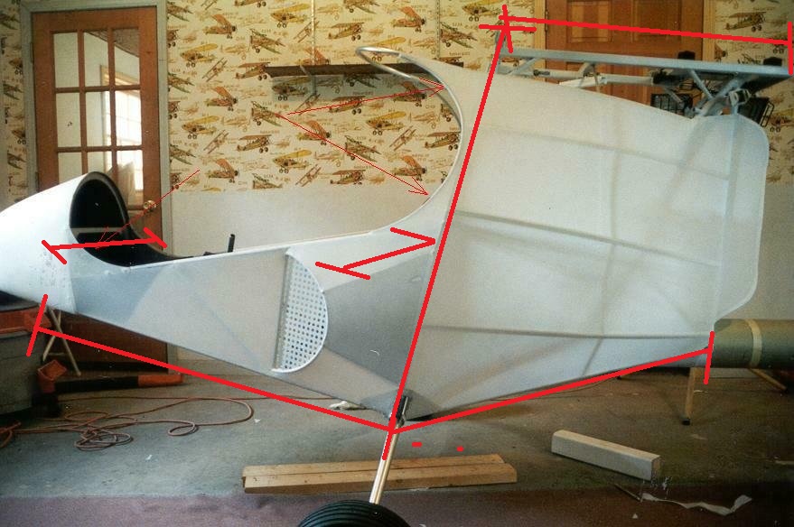

HI , trying to get the stock dimensions for the Kolb FSll cage ...(length , height ,width)
Any help would be greatly appreciated
Thankz
PS: a drawing would be great too!

Don't have a drawing, but the length is approximately 94" from just behind the boom through bolt to the bottom front, the width at the cross member directly behind the seat is 25 1/4" outside to outside, and measuring on sort of an angle from the bottom of the fuselage directly below that cross member to the top of the front spar carry through is 45".
Not guaranteed to be exact, only approximate.

If there are specific measurements you want I will be able to go to the hangar Tuesday night and get those measurements.

As i 've said mostly CAGE 3 views dimensions.

Once again, I will gladly take time to measure anything you need, I will be in my hangar Tuesday night, tell me which measurements you need. I have FireStar kit s/n 636 and cage number F1203
