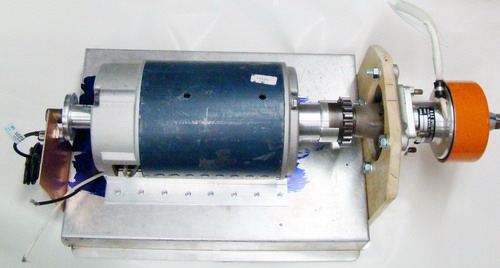

I'm assembling a drive stand to do detailed
energy studies on a range of R/R options for
all of the B&C PM alternators. Kind of swamped
right now with EMT classes but the drive stand
is about ready to run.
[img]cid:.0[/img]
Please don't take this as any discouragement
for gathering your own data. I'd be pleased
to know your findings. 2400 RPM is a bit slow,
the SD-8 doesn't reach full rated output
below 3900 or so. Getting a grip on those
critters to spin them is a bit of a hassle.
Neal George fixed me up with some OEM mating
parts for the spline. I did find that a 12-point,
socket (11/16?) fits the male spline pretty
well. I have an adapter fabricated from a
socket that I elected not to use for permanent
tooling. You're welcome to it if it's useful
to you.
In any case, I suggest you mock up a complete
alternator-battery-load system. It should
come alive and work for you then.

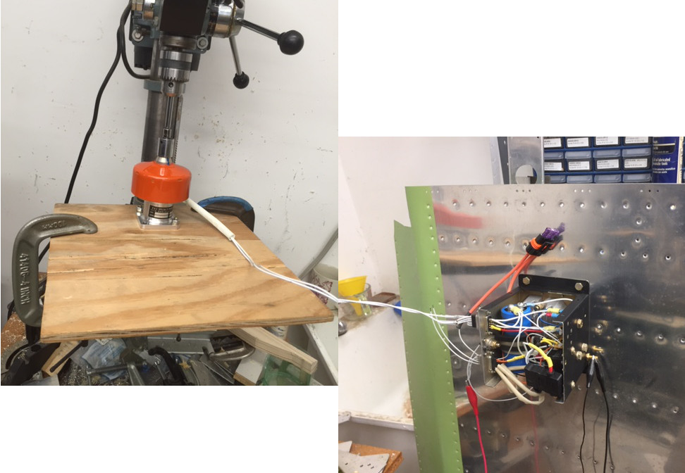

thomas.n.gautier(at)jpl.n
PostPosted: Wed May 18, 2016 10:27 am    Post subject: B and C SD-8 dynamo problem Reply with quote
Bob and everyone,
Thanks for the replies.
I was aware that the dynamo regulator might not come alive without
power on its output, but I thought that was what the
bridge-rectifier/3K-resistor come-alive circuit in Z-13/8 Rev Q was for. I
canıt say that I understand just how that circuit works with the regulator
module but it reminds me of an old vacuum tube grid leak bias circuit.
Thatıs why I thought the voltage (about -13vdc) at the junction of the
resistor and rectifier would be useful.
I will test a more complete version of my electrical system with the
main battery attached and see if things work better. The best I can do is
3100 rpm for the dynamo but weıll see how that works. Iıll report my
results. I have attached a composite picture of the test set up for those
of you who are interested. The guys at BandC said driving the dynamo from
the outside end wouldnıt hurt it. The big sheet of aluminum is my stand-in
heat sink for the instrument sub-panel in the plane.
