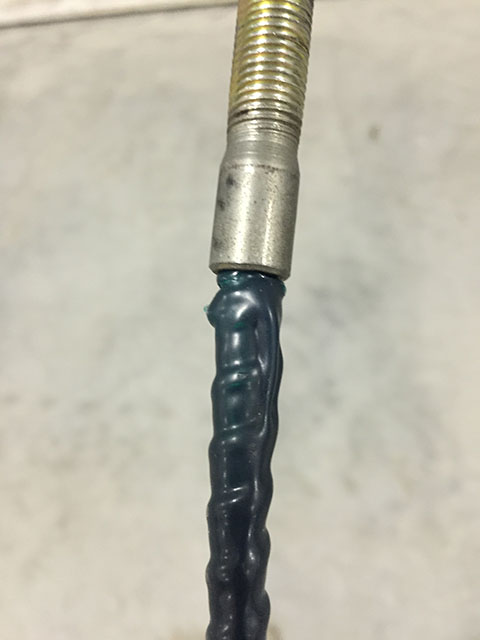

Just removed my cables. They are all sticky, but the cover at the end of the mixture cable is melted. The next set will be firesleeved as Tim suggested.
Van's cables would have worked just fine if i would have protected them from heat. They used to be nice and smooth for about 20-30 hours.
Lenny
