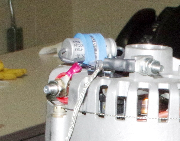

PostPosted: Sun Mar 27, 2016 10:34 am    Post subject: fused or not Reply with quote
At 07:33 AM 3/27/2016, you wrote:
thanks guys for the info. i am told it is to keep noise out of the ecu.
 bob noffs
That IS the legacy rationale for adding such things
and it's a deeply rooted idea did
a failure analysis on a modern, 100A alternator
that came equipped from the factory with a 680uF
electrolytic capacitor mounted right to the back
of the alternator.
[img]cid:7.1.0.9.0.20160327122948.0099ede8(at)aeroelectric.com.0[/img]
I am quite certain that noise from this alternator on
EMC laboratory equipment would not be materially
reduced for having added the capacitor. I'd
LOVE to see an EMC test report that illuminates
the 'benefit'.
I just purchased a spectrum analyzer that sweeps
down to 1Hz and up to 2.4 Ghz. When I begin
development testing on the next generation of
PM alternator rectifier/regulators for B&C I will
quantify the value of adding this component
to our airplanes.
