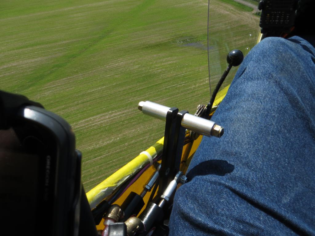

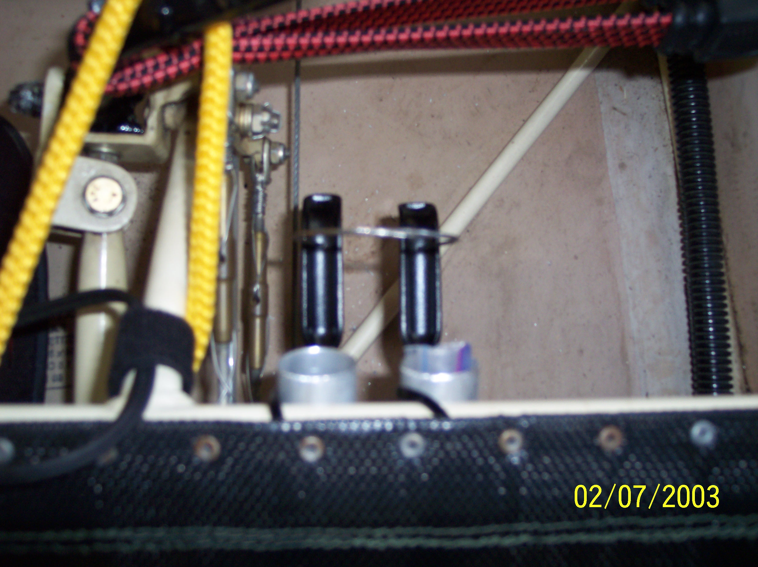

I put the Black Max hydraulic brakes on my firefly. I use a dual hand control by the throttle. Quite handy, no regrets.
 Filesize:  116.59 KB
 Viewed:  25183 Time(s)
West1m
Hastings, MN

I don't recall the cost, they came from Black Max.
Expensive but I wanted brakes flying off the blacktop all the time.

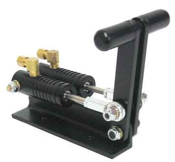

Try these for dual hydraulic hand brake actuators. I did something similar on my old Firestar with the levers just in front of the seat between my legs. I used Mt Bike brakes but this would work. This is similar to what we had on a drifter in my hangar at one time and it worked excellent. And lots less than 500. Maybe buy the throttle like the one picture as part of this subject. Shop around for the best price on 5" or 7" levers. Hagar is the brand. Good Luck and I'll get out that way sometime.
https://www.cps-parts.com/categories/aircraft_parts/ap/menus/lg/masterbrakecylinders_hegar.html
Dual hydraulic brake master cylinders.

lcottrell
Joined: 29 May 2006
Posts: 1494
Location: Jordan Valley, Or
PostPosted: Tue Mar 01, 2016 1:00 pm    Post subject: Hydraulic brakes? Reply with quote

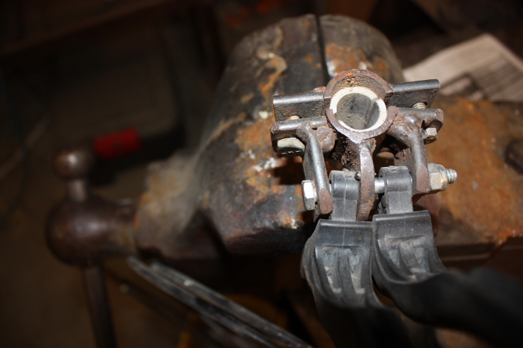

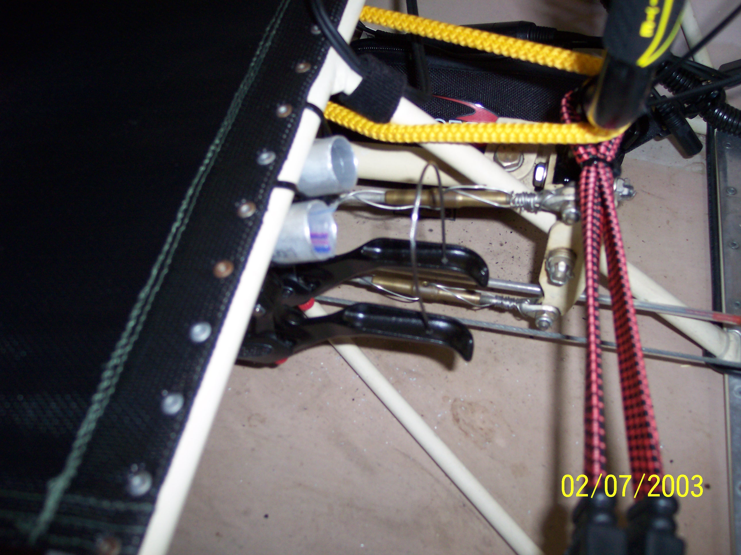

Using my mech brakes I came up with this and it worked very well. I found it much easier to control my plane with these and using the rudders. They at least were always positive, where as I find it difficult sometimes to get my feet where I want them and use the rudders as well. Perhaps I am just clumsy!
I had to do a bit of welding, but it worked just fine.

Richard Pike
Posts: 1671
PostPosted: Tue Mar 01, 2016 3:30 pm    Post subject: Re: Hydraulic brakes? Reply with quote
Looks like their are all sorts of ways to skin this cat. Here is how we did it in the FSII: instead of pulling back you push down. (Did it this way because it was easier to weld in the brackets and make everything fit. Bleeding the air out is a pain tho...)

PostPosted: Thu Mar 03, 2016 7:50 am    Post subject: Re: Hydraulic brakes? Reply with quote

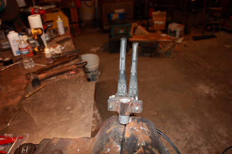

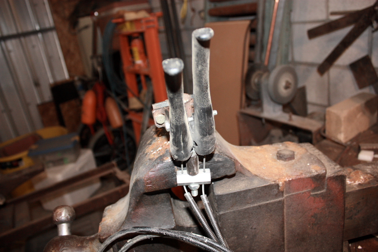

Here is my MT bike brake handles for my Firestar I that I installed before selling. Pull one or the other, or the cable loop for both. worked good for me.
