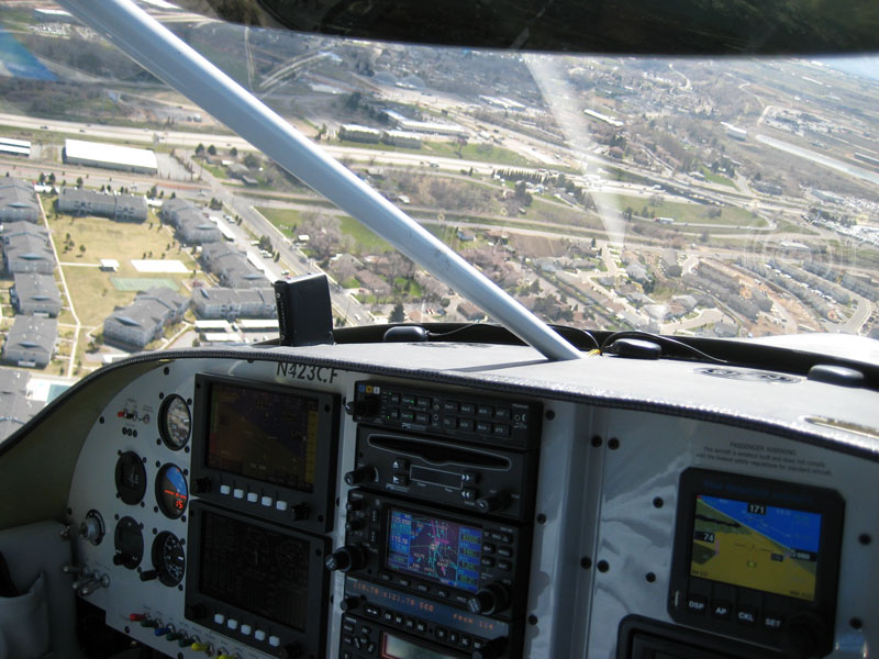

rene(at)felker.com
PostPosted: Wed Feb 24, 2016 7:19 am    Post subject: Glare-shield painting Reply with quote
I got some dashboard material from Cleveland and it works great. You just
glue it in. Also got the trim piece from them.
Attached a picture....not a great one. I did this after the wind screen was
in.
Rene'
801-721-6080

arplnplt(at)gmail.com
PostPosted: Wed Feb 24, 2016 1:15 pm    Post subject: Glare-shield painting Reply with quote
I used a spray on, black bed liner product from a local auto parts store.Put on several coats till the can was gone. Zero glare or windscreen reflection as well as non-slip. Tough as nails.Dave LeikamN89DA
