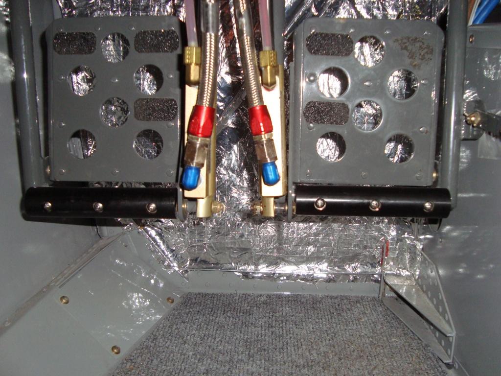

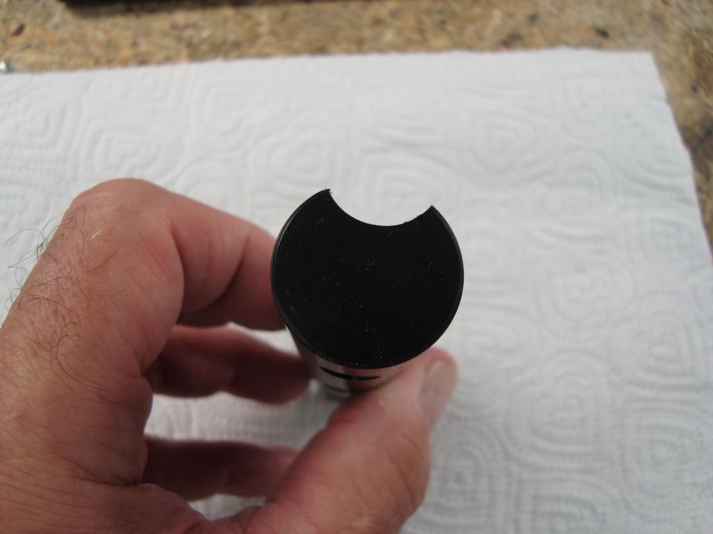

It is easy to drag a brake. Here is a note I sent out a few months ago on the subject.
My son and son-in-law are Naval Aviators. As is easy to do, both have a tendency to drag the brakes. A good friend of mine, Tom Doran, made these extension on his milling machine from 1” Delron. He even made me one out of steel for me to use as a drilling gig. I used a couple of hose clamps to attached the gig and drill the #19 holes.
While I did this to help the son and son-in-law I confess I found them to be much better than just the stock set up.

PostPosted: Sat Feb 13, 2016 7:17 am    Post subject: maintenance tips Reply with quote
Along with 'heel pads' you can put an additional compression spring on the master cylinder shaft to help it relax fully.  The angle of the pedal just naturally makes it easy to drag the brakes.
As John Miller posted, short, hard brake pressure is always preferable to dragging the brakes due to the heat.  Tail-dragger pilots should be used to that already.
AFAIK, the original Matco brake disks are a little thinner than their Cleveland counterparts and don't have as much mass to store a lot of heat.
