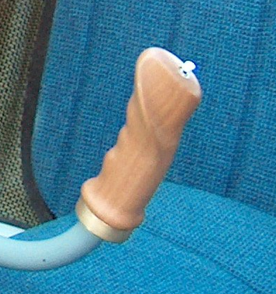

My dad creates the stick grips out of cherry wood (I have already a pair in my Glastar (don't put the mic key on top!)),
[img]cid:part1.05080802.08060807(at)gmx.net[/img]
 now for the RV10 you have 2 electric trims, one version would be two switches in the panel, but I like to sit in flying position to trim, so a collie hat would be the ideal scenario for me.
What is the list experience (this will be low amps as no direct drive) with that kind of switches? Any sources for it (found some from Digikey).

I suppose that the guy who sells the Infinity Stick grip also sells the components, including the Hat switch.
Try  http://infinityaerospace.com

Beautiful stick grip! Questions:
1. Does your Dad do these commercially (i.e. for sale to others)?
2. Is it an ambidextrous design? (I fly with either hand on the grip.)
3. I would only want a coolie hat on top and a push to talk toggle in front.
4. I need two grips.
If yes to all these questions, perhaps we could take the conversation off-line.

Otto switch has many to chose from.  Aerospace quality... aerospace price too!
http://www.ottoexcellence.com/products/4-way-mini-trim/
