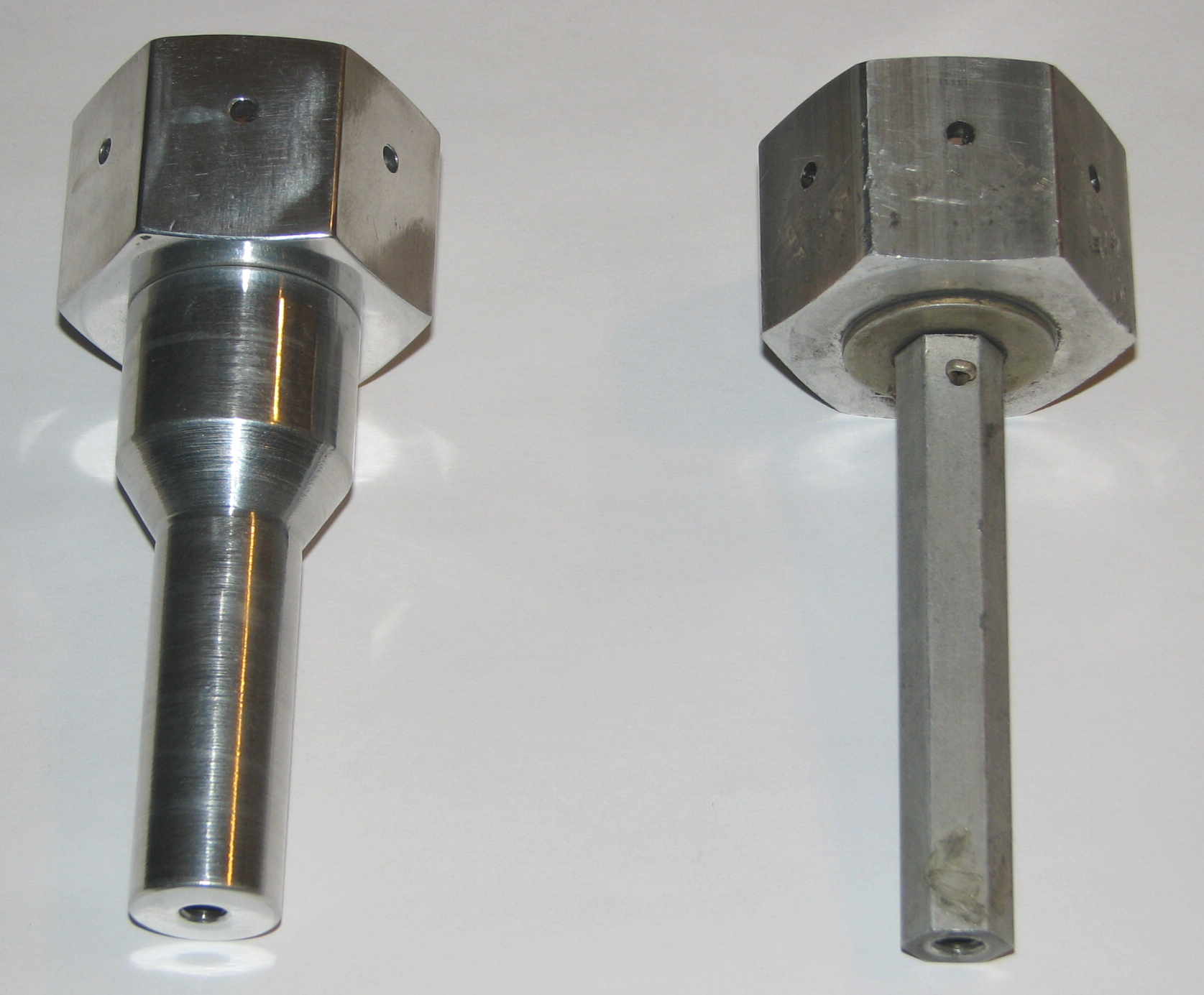

I don't see any axle extensions (U-1004B) listed as mentioned on Tim Olson's page here:
http://www.myrv10.com/N104CD/upgrades/20070118/index.html
although the U-1004A axle nuts are listed.

IIRC, The stock axle extensions are just cut from hex-cross section stock. They are too small in diameter, the larger diameter after-market replacements are very desirable - I'd say necessary.

As far as I'm concerned the stock axle extensions are not adequate.
I made about 30 sets. Attached is a pic (mod vs. stock).
Don McDonald

I have the original axel extension and fly out of grass strip. 1100+ hours and no issues.
Do not archive.
Rob Kermanj
Sent from my iPad
Bob Turner
RV-10 QB
http://forums.matronics.com/viewtopic.php?p=451540#451540

PostPosted: Sat Jan 02, 2016 6:52 am    Post subject: Finishing kit mods Reply with quote
The aftermarket extension was the very first accessory I bought for my
'10 back in 1996. It finally flew late in 2011 when I put the pants on
after engine break-in. A little over 500 hours and approximately 150
operations off of a grass strip, one of the extension ends stripped and
had to be replaced.
I like the aftermarket part - it looks good and appropriate to the
task. My guess is that the original axle extension works just fine as
well though it doesn't quite look up the stresses and strains I imagine
the part enduring. Key words here are 'like', 'guess', 'look' and
'imagine'. I don't recall anyone here actually having a bad experience
with the original part or design (?).
If I were building again I think I'd use the original part and if it
failed, replace it with the aftermarket one.

PostPosted: Sat Jan 02, 2016 8:00 am    Post subject: Finishing kit mods Reply with quote
Here's the reason I made the extensions.... I thought the originals were wimpy. So after making 1 set for my plane, a friend of mine, with a 10 already flying, stopped by and saw them on my plane. Thought they looked a lot better.... well not 3 weeks later he came by and asked if I could make him a pair because one of his broke. At that point, I gave him mine and made up a bunch of them.
That's my story, and I'm sticking to it. Really wouldn't want to be 1,000 miles from home with a broken one.
Don McDonald

PostPosted: Sat Jan 02, 2016 9:49 am    Post subject: Finishing kit mods Reply with quote
I had the original parts on a plane and one side broke, taking the wheel pant with it. The bolt holding the rod to the axle nut is what broke. I won't use the stock part. If a plane comes into my shop with them, I replace them with the aftermarket parts.
Jesse Saint
