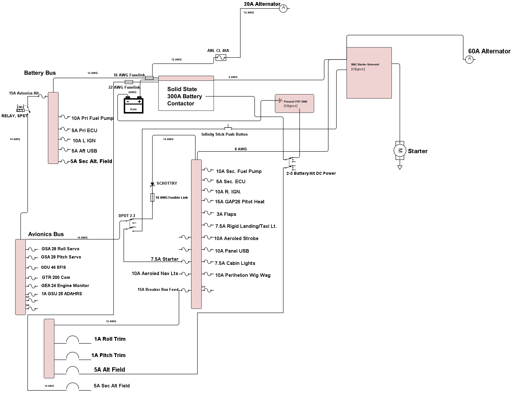

I'm working on my electrical system design. My plan is to install the EFII system using two alternators and one battery. The primary ECU, injector, fuel pump, and ignition will be powered off the always hot battery bus with the secondary set of the above powered off of the main bus.
I've chosen to install a couple of fusible links in areas where the aeroelectric connection book recommends wire runs 6" or less and I was unable to achieve that. I'm not sure if a run of 2-3 ft would require a fusible link... still scratching my head on that. I haven't completed the diagram quite yet as I haven't decided on which alternator/regulator combo to go with so that portion is left mostly out at this point.
Avionics haven't been purchased yet but I'm leaning towards the Garmin G3x suite of instruments.
Any feedback would be very appreciated. I apologize for the quality of the drawing.

Does the solid state battery contactor conduct in BOTH directions?
Is it rated for starter current?
The 60 amp alternator needs a fuse located close to the contactors.
If the 5 amp alternator field wire shorts out, the 15 amp fuse will likely blow before the circuit breaker trips. I recommend not putting two circuit protection devices in series.
A separate avionics bus is not necessary and introduces unnecessary failure points. Read this thread:

The solid state disconnect is rated at 300 amps with 500 amps for one second. It's not clear to me whether it is rated the same in both directions. Here is a link to the documentation they provide. http://www.waytekwire.com/datasheet/44407.pdf
Good catch on the ANL fuse. I'll put that in.
For the breaker bus feed, would you just leave that 12 gauge wire unprotected from the main bus?
Any comments on the location and usage of the fuse links?
Also, I'm conflicted about the placement of the primary and secondary engine related items. Any recommendation on which bus to locate the primary ECU, ignition, and fuel pump?
Thanks for your time and critique.
The short answer is yes. Ideally every wire should be protected against over current and short circuits. But the consequences of opening a circuit must be considered. In this circuit, over current is not an issue because the circuit breakers protect against that. What about short circuit protection? It depends on the length of the #12 wire and danger of the circuit breaker bus shorting to ground. If good workmanship is used, wires are well supported, and bus is insulated, then I would leave that 15 amp fuse out.
But why even have that bus? Connect the alternator field breaker to the main power bus with a short wire. Move the pitch and roll trim circuits to the essential bus and protect them with fuses, not breakers. If a fuse blows, there is a reason. Wait until safely on the ground to troubleshoot.
Consider replacing the 15 amp avionics fuse with a fusible link.
The DPDT switch, used in series with the diode and used for starter interlock, is unnecessary. If eliminated, it can not break.
Notice on Bob's Z-13/8 that there is a fusible link connected to the top of the endurance bus. That fusible link protects the wire (if shorted) above it from current coming from the main power bus.
Maybe eliminate the fusible link supplying power to the battery bus. If properly installed and insulated, the battery bus will not short to ground. I would rather take a chance on that #12 wire burning open than have the engine quit because the fusible link failed.
Fusible links are SELDOM needed . . . 99%
of all your branch circuit protection should
be done with fuses/breakers.
Draw up a power distribution diagram . . .

First off... thanks to everyone for taking to time to weed through my diagram and offering suggestions.
The idea of having the trim on circuit breakers was to have a means of disconnecting the pitch and roll trim in the rare instance of a runaway trim. I suppose a switch could be used for that regard but I thought circuit breakers would be a better way to kill two birds with one stone. I do not intend to have the need to use the circuit breakers as a switch on any type of regular basis.
I was using this switch as a means to disable to avionics bus during engine start along with a means to disable to starter from the pushbutton on the infinity stick during flight in case it were to be inadvertantly pushed. The switch is rated at 15A which might in itself be a point of failure at some point as you suggest with your link regarding avionics busses.

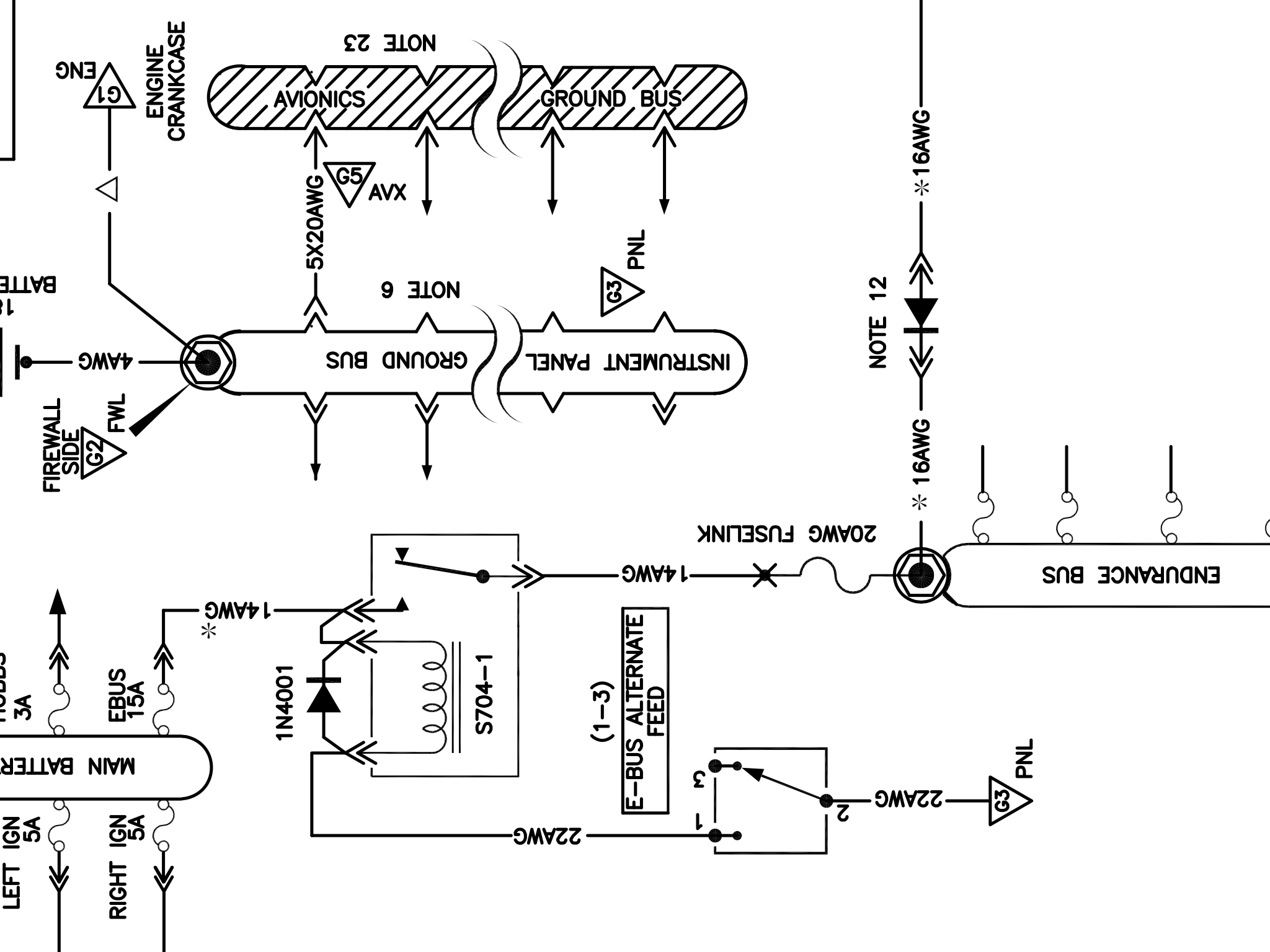

I added this to my diagram, thanks for point that out.
This was the main fusible link that I was concerned with. I think I'll remove this one as well. The wire run will be well supported and is fairly short.

That's what I'm trying to do with the diagram I have uploaded. I know it's not CAD quality but will it not suffice for these discussions and for future reference?

Attached is an updated version of the schematic with a couple of the recommended changes. Any additional advice is appreciated.

Having a switch to disable the stick grip start button is a good idea. But disabling the avionics bus is not necessary and introduces a failure point. Notice that none of Bob's diagrams have a switch in series with the diode that feeds the E-Bus.
Did you mean to insert an 18 AWG fuselink, not 20 AWG? If the avionics bus has a few extra fuse slots, the aux input could be back fed through a fuse instead of using a fusible link.
Yeah, I guess part of the idea with having an avionics switch was to have to turn something on after engine start which also disables the stick mounted starter switch. I'll do a bit more thinking on that one.
I chose 18 AWG for the fuselink as that was 4 wire sizes smaller from the 14 AWG that I have tying the main bus to the avionics bus. Is that not the correct way of thinking?
As of right now, the avionics bus has a couple of open slots. I was hoping to keep that open for future expansion is possible though.
Yeah, but you put "20" on the latest schematic.

Oh... That fusible link. I think I might have taken one of Bob's drawing too literally. That's what it shows on the z13/8 in my version of aeroelectric connect. A 20 AWG fusible link for a 14 AWG wire.
In ONE PLACE ONLY . . . the extension of
the main bus to the crowbar OV breaker . . .
and this only in some sense of deference
to design philosophies on TC aircraft.
I may remove all references to fusible links
in Rev 13 . . .
