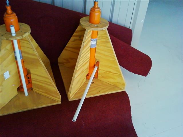

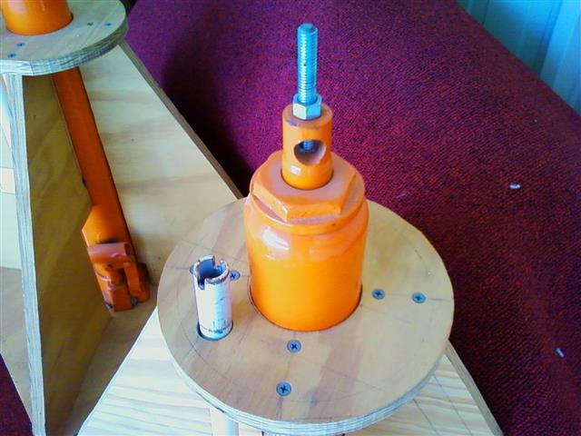

I use the Harbor Freight long ram jacks. I drilled a hole in the top of the ram and use a threaded stud that screws into the tiedown point and sets in the top of the jack. Can't fall off of the jack this way. When you want to raise the nose wheel just pull down at the tail tiedown.

PostPosted: Mon Jan 04, 2016 8:11 am    Post subject: Distance from ground level to wing tiedowns Reply with quote
I'm curious since there have been a couple of responses that screw into the tiedown and are fixed to the top of the jack.  How does the dihedral angle affect insertion into the tiedown ring that's perpendicular to the bottom of the wing?????

PostPosted: Mon Jan 04, 2016 9:32 am    Post subject: Distance from ground level to wing tiedowns Reply with quote
I have and prefer the socket type thing that I did
too, but after looking at Albert's pictures and
reading Linn's email, I think there are just a couple
of comments on that.
I think Albert's idea is workable. The things I don't
like are 1) the dihedral issue that Linn pointed out,
and 2) the use of a completely threaded fastener.
The thing is, if it did rock, the threaded fastener would
have that bending force put on at the top of the jack
and could snap the threaded fastener in half. The problem
would be worse the tighter fit the hole is in the jack
head.
But, in his defense...if you used a big enough hole that
there was some room for the plane to tilt without bending
the bolt in the jack head, there really isn't that much
weight or force on the jack if the plane is kept pretty
level. So there's no reason that idea couldn't be used
if someone wanted to do it that way. I just think
that by using a socket on the upper end, you take away
the risk. If someone really wanted to cobble it together,
I'd say get yourself a metal 1.25" pipe cap and put a bolt
through it with a nut on the back side, then screw that
up into the wing tiedown.
The things I like are then that you can then use a
grade 5 or grade 8 bolt rather than the softer
and weaker carriage bolt or stud.
Anyway, there are many ways to skin the cat. Maybe
less ways to make the cat taste good when you cook it. Smile
Tim
