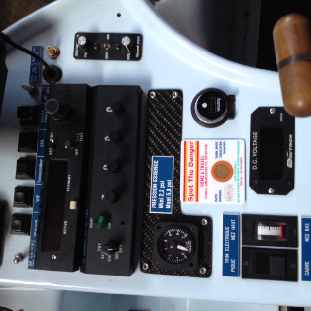

Hi to all,
I will be modifying my avionics panel and would like to prepare the new one prior to stripping out the old one.
I intend reusing the trim switch, it's position indicator and the square type circuit breakers.
Does anyone know what the hole cutout sizes are for these items?
Attached is a photo showing type of switches.
John

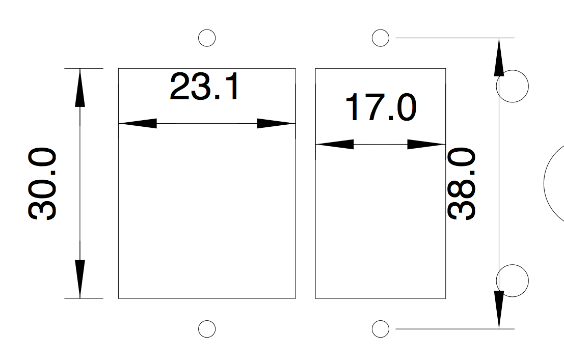

John - here attached is a screenshot of a small part of my radio panel drawing with dimensions (in mm) added. An export from this drawing was used to water-jet cut the panel, and the switches fitted pretty well - see:
http://www.rowlandcarson.org.uk/aviation/europa_435/radio_panel_populated.php
However, it appears you have the meter-type indicator rather than the LED bar that came with my kit, so the hole size for that could be different.

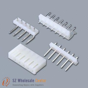

Note: The indicator and switch are disgusting to wire due to the small #26 gauge wire and the dumb fact they are surface mounted and use #2-56 screws to hold them.
Consider the following:
Buy the appropriate D sub pins and crimper for these angel hair wires to make removal and replacement easier or I solder the wires to a pcb pin connector (shown in attached .jpeg) for the switch and indicator and mount the trim switch and indicator plugs on a board but you can let them hang free. I Wire the board to the airframe using about a #20 to 22 wire to the panel to airframe plug because I am annul. but I can slide out my transponder to get quick access to the board for unplugging.
Also, I redux a tapped strip of .032-.040 aluminum as my nutplate so I never have to try to get a tiny nut off the back of a hair like screw. Life is too short and my eyes and patience are not what they used to be.
To service a bad indicator or switch, simply unscrew the switch, pull the wire forward, disconnect the pcb connector. Remove the pcb connector from the bad indicator/switch and solder on to the new one. Plug it up, screw it back together and leave in less than one hour.
