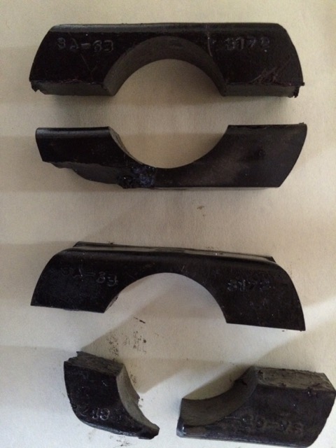

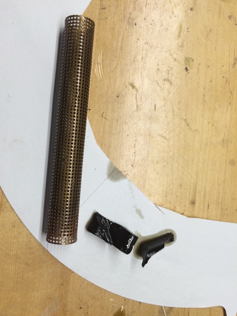

On my last flight, I felt a miss on climb out so I decided to pull the mags and take a look.
As soon as I pulled the mags, I noticed that pieces of Mag Drive Cushions were missing on both mags and I could not find them in the mag hole.
So I drained the oil and pull the Oil Suction Screen out and to my pleasant surprise, both pieces were found in the strainer.
The part no. for the cushions is LW13641. I recommend that they are replaced every time the mags are pulled out. The new parts feel soft and the old parts were brittle, I assume due to heat.
The cushions are held in place temporarily with fuel lube during the mag installation so you want to be sure they do not fall out while you are inserting the mag into the drive.
The mag components all checked out and everything looked good. I cleaned all the parts and replaced one rotor and the engine runs very smooth now. Not sure if the cushions had anything to do with the engine miss or not.

I installed two Slicks on a newer Lycoming at work the other day.  The drive pads were a different design with tabs that engaged slots in the drive gears.  It was pretty easy to feel the pads snap into place, and once engaged they stayed in place really well.
I know in the past (my own plane in particular) I've battled trying to keep the pads in place while wresting the mags into the holes.  The new design makes it pretty easy.

You don't happen to have the info on the p/n or manufacturer and compatibility with our IO-540's do you?
I've had mine out a couple times but have not replaced them and they're almost 1200 hours old so I figured I'd order 2 or 3 pairs, since I'll have 2 airplanes to care for.
Tim
On Dec 6, 2015, at 7:29 PM, David Saylor <saylor.dave(at)gmail.com (saylor.dave(at)gmail.com)> wrote:
--Dave
On Sun, Dec 6, 2015 at 12:16 PM, Rob Kermanj <flysrv10(at)gmail.com (flysrv10(at)gmail.com)> wrote:

Tim,
Although having a fool-proof part is the way to go, the fuel lube solution works well but needs care to install.
If you can't fit the redesigned cushions in your installation, I would not hesitate to use fuel lube.

I poked around and found Lyc Service Instruction 1299B. It has p/ns, pictures, applicability, yada yada. I'm not sure if they work on all Lycomings but the SI gives SN ranges. --D

Just a clarification: The SB shows a new cushion design and a new mag drive as a matched set that prevents the cushions falling into the case during installation. The issue of the cushions getting brittle, breaking and falling into the case remains.
