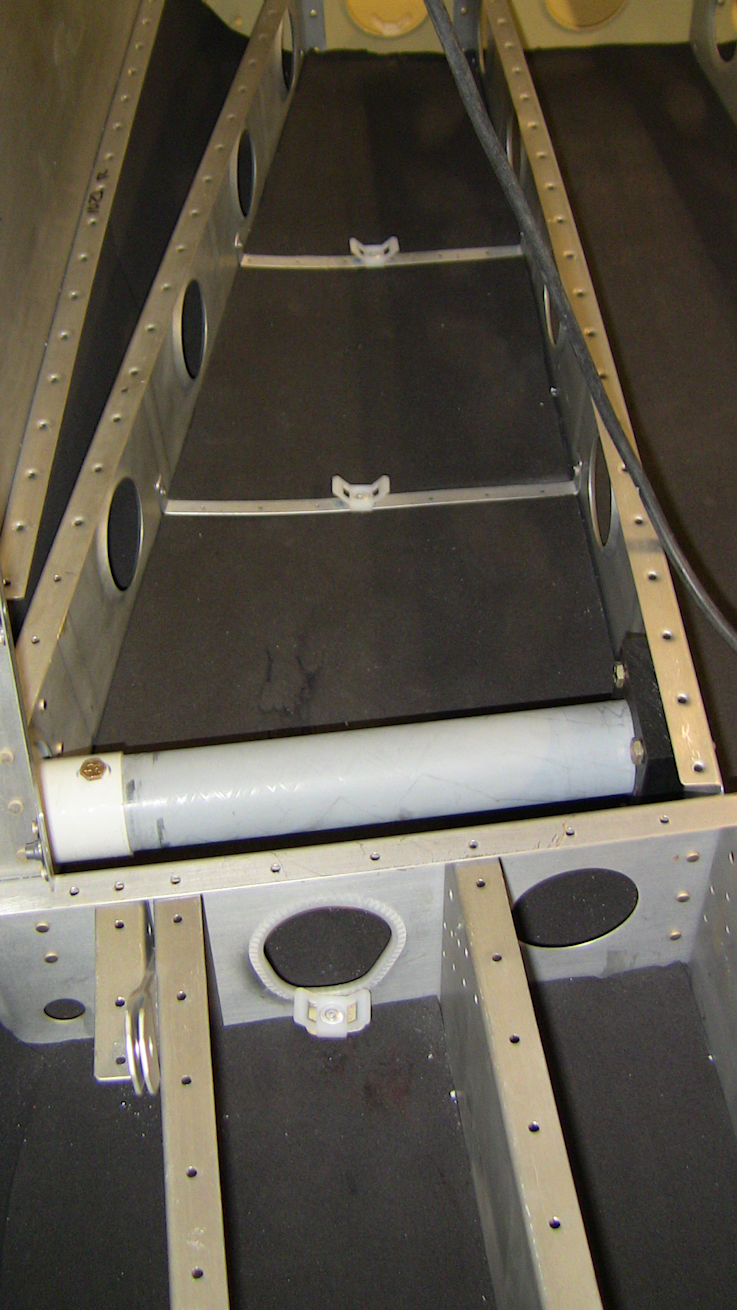

PostPosted: Mon Nov 23, 2015 2:35 pm    Post subject: Securing Conduit Reply with quote
I would not let them flop. I used 1/2" Sched. 40 (thin wall) PVC pipe
and plastic 'hangars' made to hold the pipe under a ceiling joist ...
picture the pipe clamp with vertical 'ears'. I riveted the pipe hangar
to the side of the larger lightening hole. The plastic clamp has to be
spread out to fit around the PVC pipe .... I tried the ribbed plastic
conduit and just couldn't make it work for me .... all of it ended up in
the recycle bin ..... and the smooth PVC pipe makes running more wires
really easy.

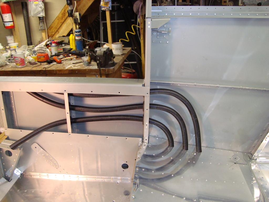

carl.froehlich(at)verizon
PostPosted: Mon Nov 23, 2015 4:00 pm    Post subject: Securing Conduit Reply with quote
If you are talking about the lighting holes in the side fuselage, you can
get a rubber grommet that fits it just right - and the ID provides a good
friction fit for the conduit (I got mine from Stein Air
http://www.steinair.com/store.cfm?tlcatid=14 ). For under the rear floor I
make a strap. For new holes, as Bob says make the hole small enough to be a
friction fit for the conduit. Do not make the turns too tight so you can
use a string to run wires.
I ran three conduits on each side and ended up filling five of them.
Carl

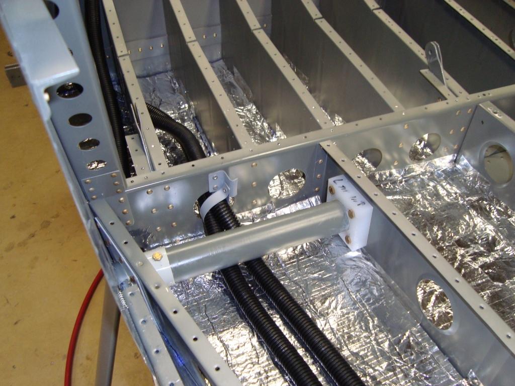

glastar(at)gmx.net
PostPosted: Mon Nov 23, 2015 11:14 pm    Post subject: Securing Conduit Reply with quote
Steve,
I used some clamps mounted either on an L shaped alu angle or on a strip of scrap alu
[img]cid:part1.01050800.05050504(at)gmx.net[/img]
