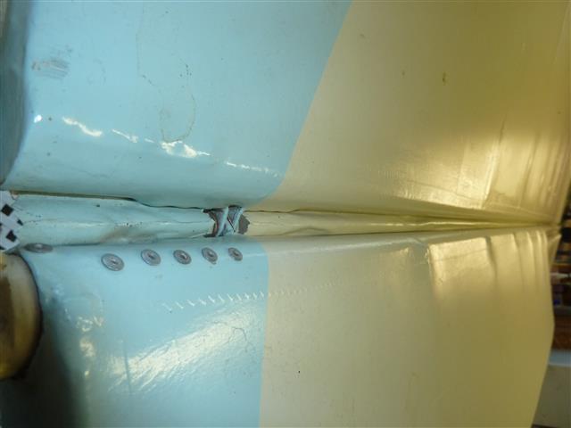

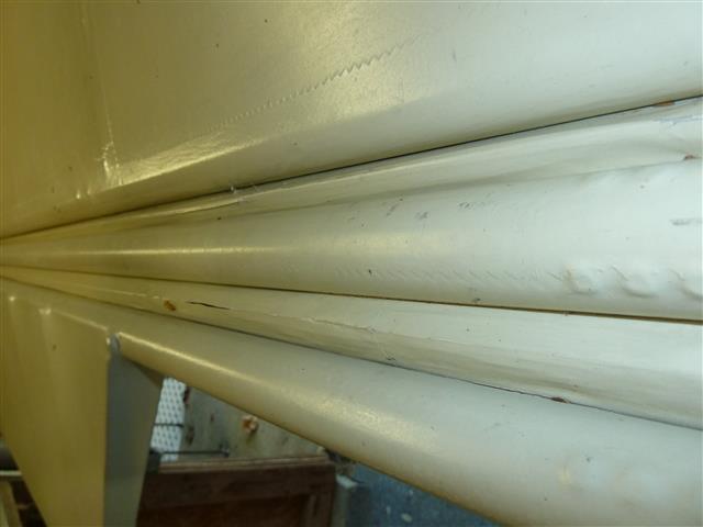

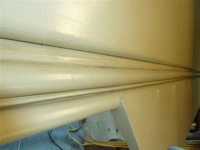

PostPosted: Tue Sep 01, 2015 2:12 pm    Post subject: Re: Aileron Gap Seals Reply with quote
What John said. Here is what Stits fabric gap seals look like after 20 years. The area within the prop arc is starting to crack on one aileron, will be a simple repair. This winter. Not a priority. Everything else is still OK.

PostPosted: Thu Sep 03, 2015 8:48 am    Post subject: Re: Aileron Gap Seals Reply with quote
Richard,
Thanks for the photos. I appears that the gap seals are attached to the bottom of both the wing and the aileron with a bit of slack to account for aileron movement.
I assume the are constructed out of the same covering as the wing and aileron.
