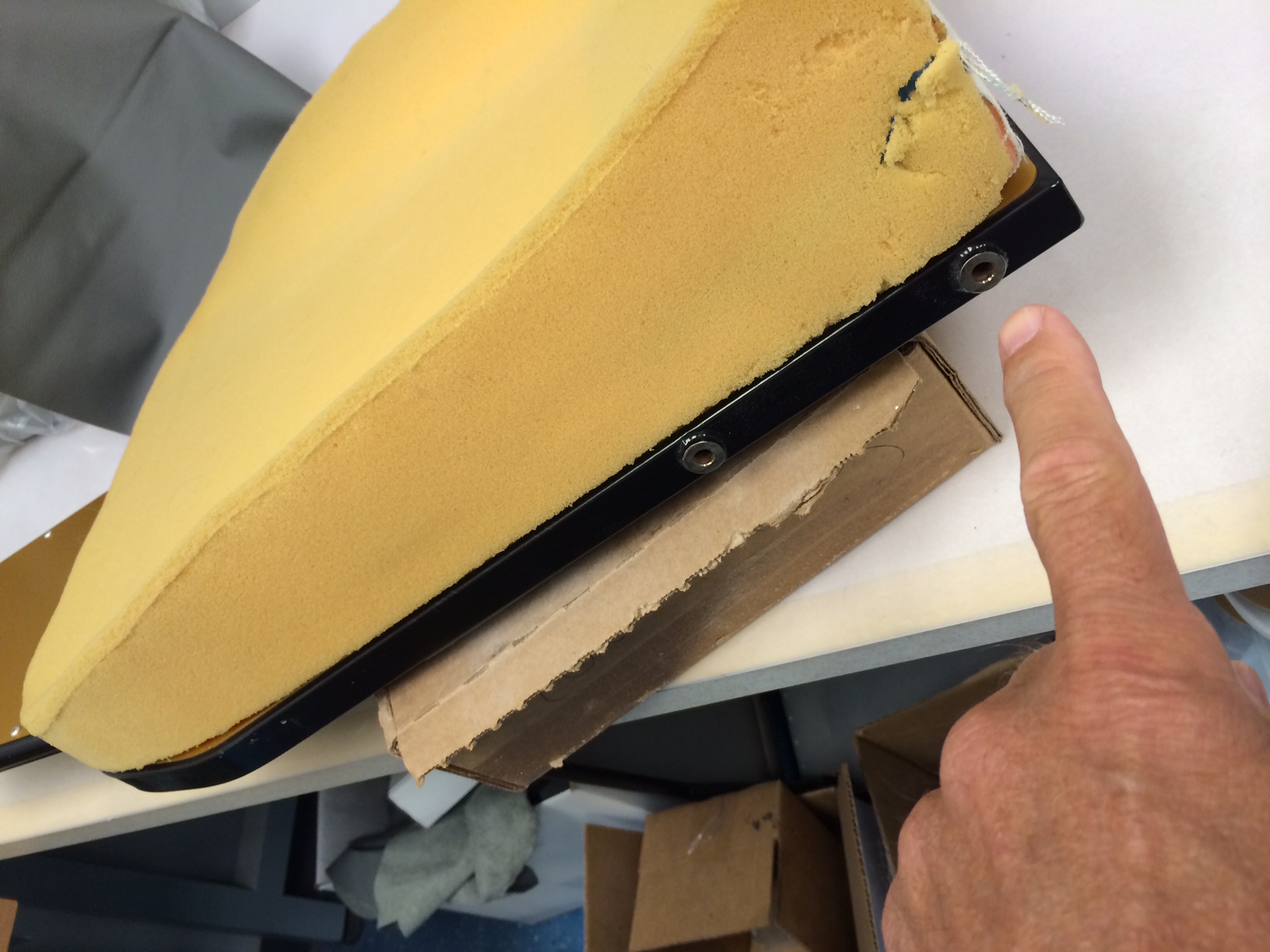

You can remove the upper back pretty easy. Roll your seat cover up about 6-8
inches and then there are 4 1/4-28 screws with
Lock nuts remove these. Very easy. See photo They might be a little harder
to get to while in the aircraft
Geoff Combs
