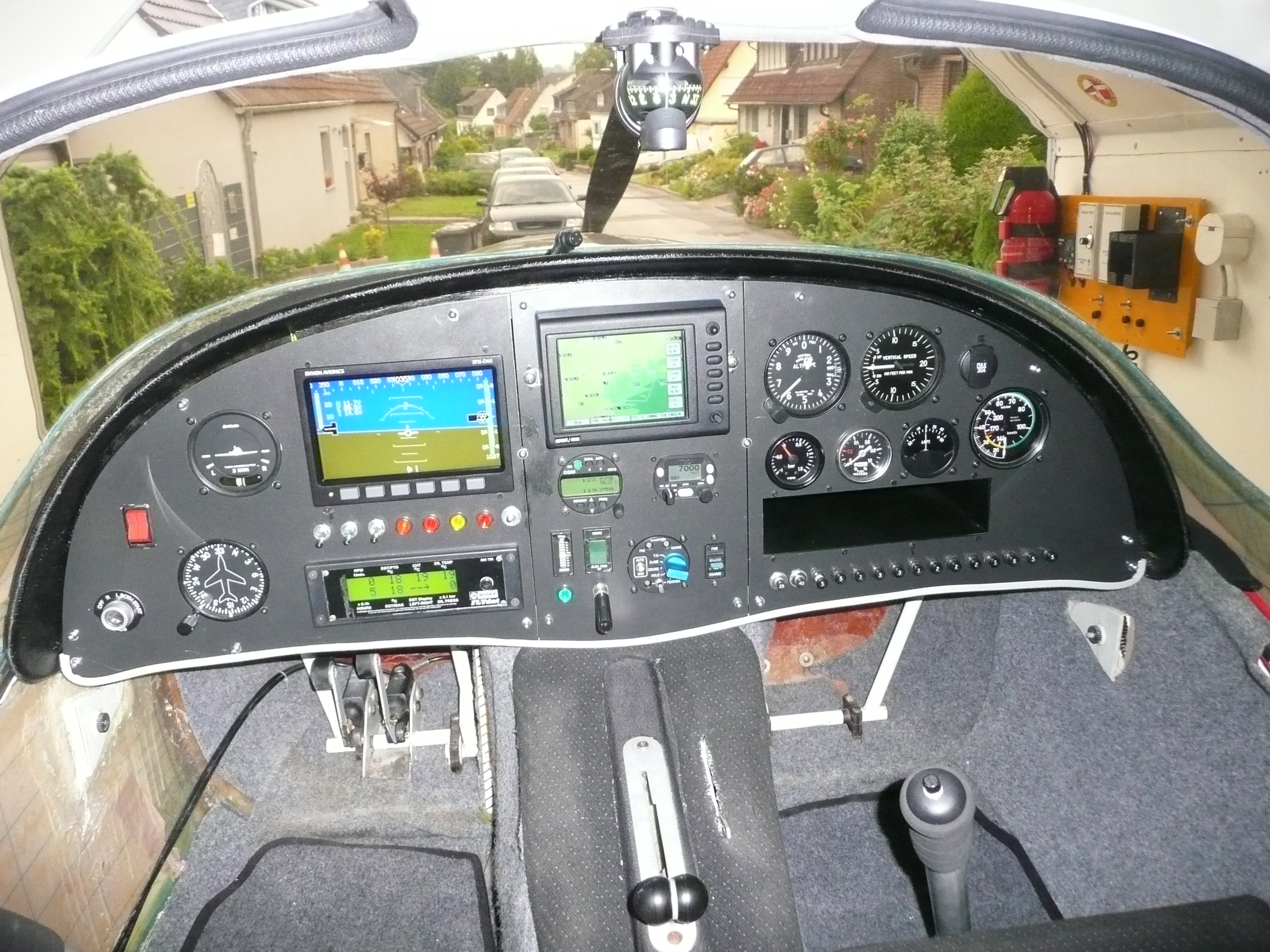

PostPosted: Mon Aug 10, 2015 8:59 pm    Post subject: Re: aluminium avionics panels Reply with quote
Hi John,
I have made a whole new panel, however it's not "LAA-certified".
I could arrange a new kit (upper GFK-cover and Aluminium-panels/3 sections) for you at the shop in the Netherlands if you are interested.
Roland
PH-ZTI
XS Trigear 914

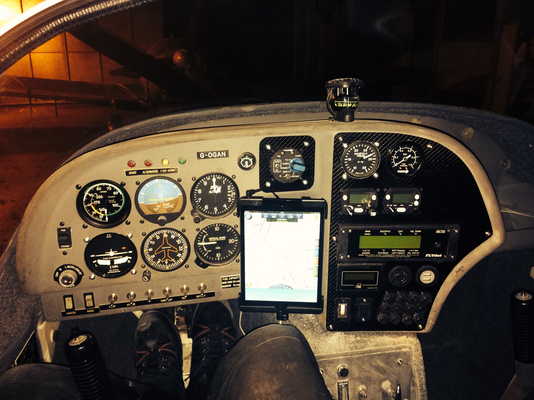

PostPosted: Tue Aug 11, 2015 12:35 am    Post subject: Re: aluminium avionics panels Reply with quote
I bought the Europa aluminium blanks, and then cut what I needed out of carbon fibre.
