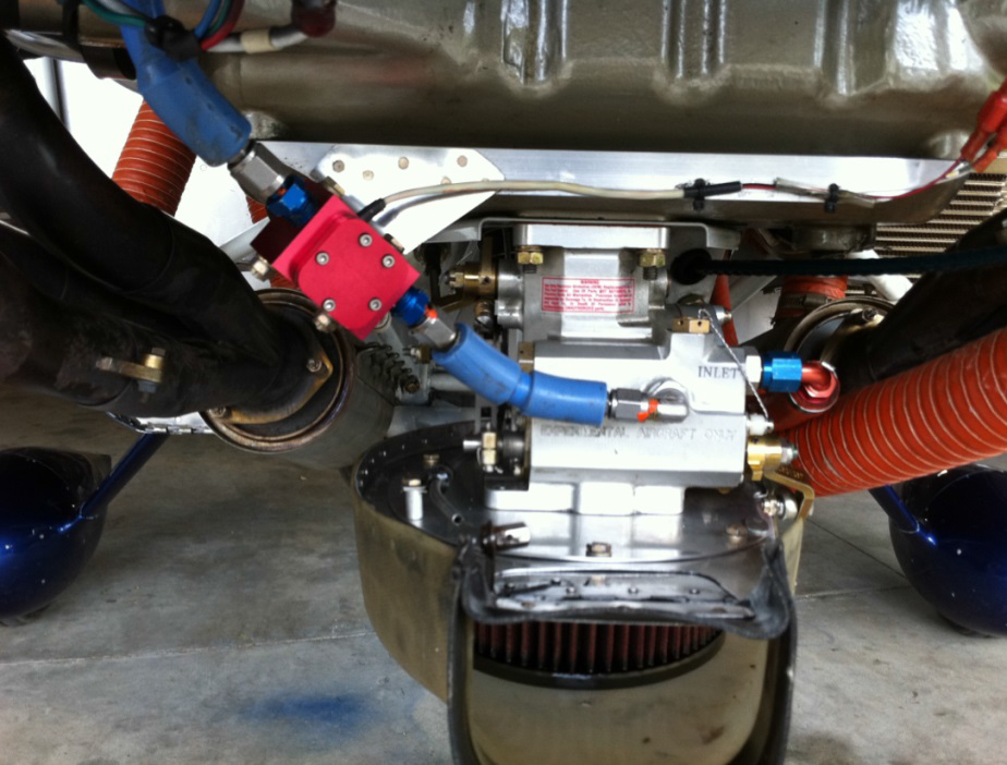

PostPosted: Sun Jun 28, 2015 5:48 am    Post subject: Red Cube - Floscan Reply with quote
Initially, the floscan was in the tunnel & I was experiencing FF flucuations of 0.5 GPH, which made injector tuning "impossible!" After removing the floscan and replacing it with a red cube between the servo & distributor those fluctuations stopped & a good nozzle tune ensued!
 Filesize:  1.86 MB
 Viewed:  22364 Time(s)
 Filesize:  1.86 MB

PostPosted: Tue Jun 30, 2015 6:48 am    Post subject: More on the red cube... Reply with quote
Hi
It is very easy to make your own fuel lines (braided steel) and put on fire sleeve. You can get all the kit you need at a local speed shop.
Cheers
Les
On Jun 30, 2015, at 07:43, Ed Kranz <ed.kranz(at)gmail.com (ed.kranz(at)gmail.com)> wrote:
[quote]Lenny,
I just marked where on that fuel line I wanted the RedCube and sent the original line to TSFlightLines. Tom put the fittings I needed on the original line. It fits great, and it was pretty cheap too. The only downside is that you're obviously not going to be flying when he has your fuel line!
Ed
On Mon, Jun 29, 2015 at 10:36 PM, Rick Lark <larkrv10(at)gmail.com (larkrv10(at)gmail.com)> wrote:
Lenny, Steve from Aircraft Specialty made all my oil and fuel hoses (great to deal with btw), my servo to red cube hose is 12", the red cube to spider is 21". Of course it kind of depends on the location of the flow transducer. Mine is on a SS bracket just under the case, almost identical to what Ivan Kristensen did.
Rick
On Mon, Jun 29, 2015 at 6:18 PM, Lenny Iszak <lenard(at)rapiddecision.com (lenard(at)rapiddecision.com)> wrote:
--> RV10-List message posted by: "Lenny Iszak" <lenard(at)rapiddecision.com (lenard(at)rapiddecision.com)>
Does anyone have the lengths of the two hoses required to move the redcube between the servo and spider?
Lenny
http://forums.matronics.com/viewtopic.php?p=444195#444195

PostPosted: Thu Jul 02, 2015 12:25 pm    Post subject: Re: More on the red cube... Reply with quote
Thanks for the lengths. Saves me from pulling my fancy plenum to take measurements...
I have the floscan in the tunnel and it's pretty accurate for calculating the fuel used, but it's bouncing around a lot for precise LOP adjustments.
Lenny
