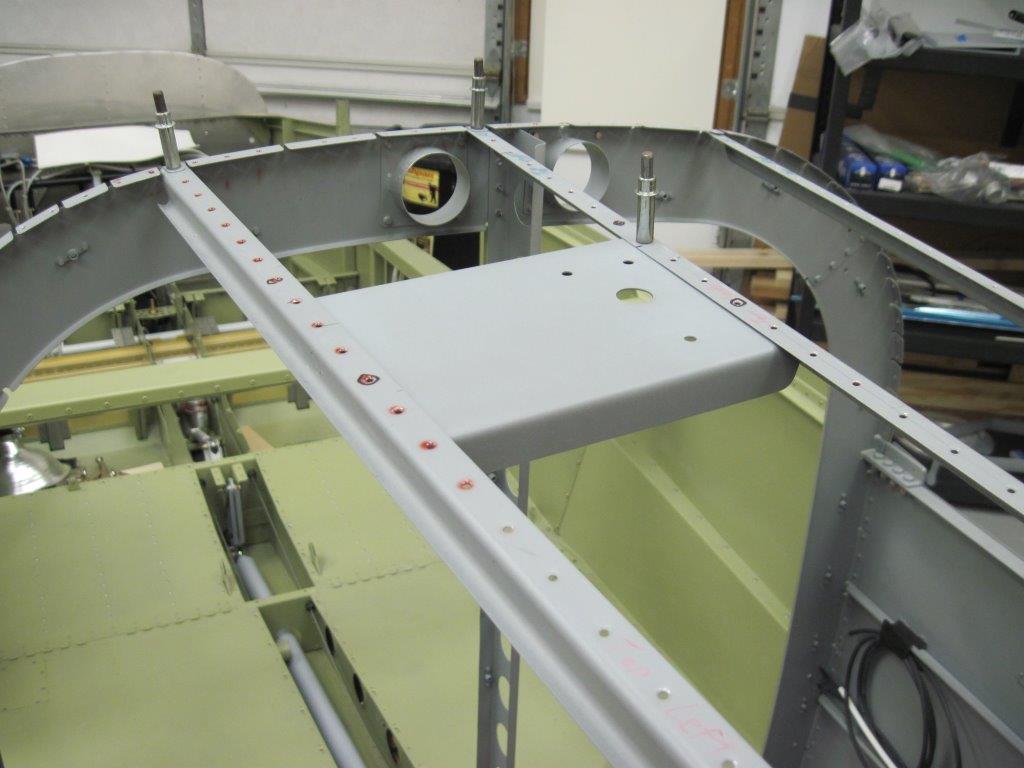

At my airport the tower is far enough away that a bottom mounted antenna just would not cut it. I have a top mount and bottom mount.
Here is a photo of the doubler I constructed spanning the two stringers. What is missing in this photo is the tapered wedge that goes between the skin and the doubler. The antenna mounting bolts go through the skin, the tapered wedge, and the doubler.
The skin is not flat at this point and if you attach a doubler directly to the skin it will flatten the curved area of the skin.

Not to argue the point as one can build as they wish.  For the others reading this thread and perhaps now worry about bottom mounted antenna performance, my experience is the same as John’s.  I’ve never had an issue with the bottom mounted bent whip communication antennas.  A specific data point was picking up my IFR clearance on the ground at KSET from St. Louis Approach located well off field.
