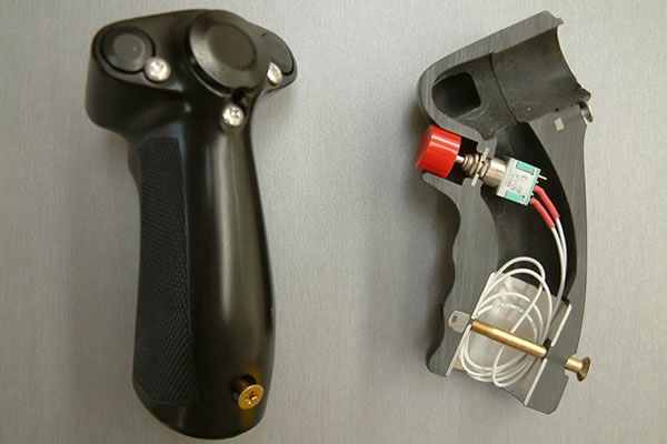

Or you can use shorter grips. I got them from a guy in New Zealand, and they clear the panel just fine without any bending of the stick. They look a bit similar to the Infinity grips, just less buttons. They are ambidextrous.
http://www.compositesinternational.co.nz/gallery/
You are probably far down the path to bending the stick Smile but just for future reference...

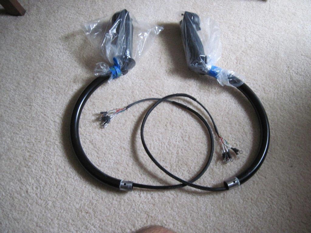

I have the Aerosport Panel and did not have to bend the stick. What I did was to cut the lower end as short as possible to leave enough straight left to slide into and fully engage into the lower attachment joint. I trimmed the top as short as possible so the holding when the grip my arm would be able to relax on my leg.
