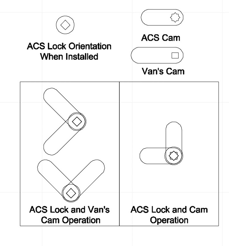

PostPosted: Thu Apr 09, 2015 7:25 am    Post subject: ACS Door Locks Reply with quote
Because the cutout is square in the Vans supplied cam, It will not rotate properly.  When the lock is installed in the door, it is off by 45 degrees.  The only way I can see making it work is to modify the square opening to an 8 point opening.  Attached is a crude drawing of what is happening.
Shannon

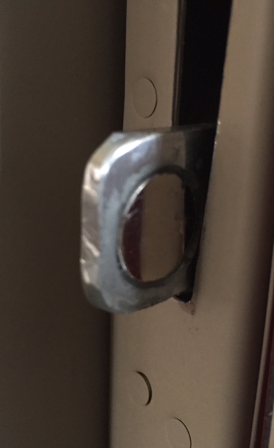

PostPosted: Thu Apr 09, 2015 4:41 pm    Post subject: Re: ACS Door Locks Reply with quote
I agree with William. Vans included a longer cam that replaces the one that comes with the lock. I ended up making one so that I could embed a disk magnet in it and then installed a reed switch in the door jamb. That switch is hooked in series with the passenger door switches. All 5 switches are hooked in series, 2 per passenger and one on the luggage door. Therefore, if any door is not latched, I get an indicator on my panel telling me, just not which one. i bought both the magnet and switch from Amazon.
Bruce Hoppe
Sent from my iPad
